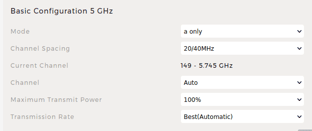

I have a 100 Mbps WiFi connection. The 5GHz band gives a speed of > 100 Mbps upload and download using speedtest.net, which is great. The 2.4 GHz band, however, gives only a speed of around 30 Mbps, even if I stand next to the router. Note that I have disconnected all other devices from the network before conducting the speed test.
I am aware that speeds on the 2.4 GHz band are lower than that on the 5 GHz band. But a difference of 70–80 Mbps, that too standing next to the router, seems huge. Am I correct? I have called the engineers from the ISP tomorrow to relocate the router inside the house; I want to bring up this issue too.

It's currently 2 AM local time. With both bands enabled, 5 GHz gives a top speed of 70 Mbps at the moment (compared to 100 in the afternoon, when most people were out for work). 2.4 GHz gives 30 Mbps max. Disabling either of the bands does not affect the speeds seen by the other band.
I also checked the router settings and found the 5 GHz channel spacing to be 20/40 MHz by default. Should I change this to 80 MHz? The 2.4 GHz band had a spacing of 20 MHz; I set that to 20/40 MHz.

Yesterday was tiring. First thing in the morning, I found that the router is actually working on b/g mixed protocol rather than n on the 2.4 GHz band. And no matter how many times I tried to change it, it still returned to b/g mixed mode.
When the technician came to relocate the router, he told me that the company has fixed all routers to b/g mixed and does not allow the n mode. Nobody knows why. He said that the max. speed will be around 40 Mbps unless I use my own router. I do have a single band router, so I connected that to the ISP router via ethernet and switched off the 2.4 GHz band in the ISP router. Got a speed of 60 Mbps on 2.4 GHz and 110 Mbps on 5 GHz. I was happy.
An hour later, the 5 GHz band stopped giving anything higher than 20 Mbps. Fiddled with the settings, but no resolution. After a whole afternoon of splitting hairs, decided to factory reset the ISP router. And that resolved the issues, except one: as others have reported, the speed on the 2.4 GHz band, even after using a router that supports n protocol, is now unfortunately not rising above 30 Mbps. No idea why. Initially, it did give 60–70 Mbps. Now it's not. Probably I have to live with that.
Edit: Interestingly, if I do the speed test to the same servers from my laptop, I get a higher speed, typically > 80 Mbps, on the 2.4 GHz band. On mobile, I am not getting higher than 30 Mbps, though I do get 100 Mbps on the 5 GHz band.

As far as b/g vs/.n, if there is a single b/g device on the network, the whole network drops to b/g speeds. That's in the spec. From experience, if there is the tiniest bit of noise or interference, the system also drops to b/g.
