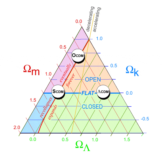

Can anyone out there help? I want a diagram with Ωm on the horizontal axis, and ΩΛ on the vertical axis, and trajectories for the universe over time as these ratios change. The closest I have is this
from cosmology lectures by James Schombert at Uni of Oregon; it shows the eventual fate of the universe, but not the trajectories through the phase space. A flat universe simply moves along the horizonal blue line, to the right for positive dark energy. What is interesting is that other not quite flat universes move towards being flat as they expand. This is what may have happened during the inflationary epoch.
Cheers -- sylas
I have a book open in front of me, General relativity: an introduction for physicists by Michael Paul Hobson, George Efstathiou, Anthony N. Lasenby, that, on page 416, has a couple of these diagrams with a few trajectories in each diagram. Unfortunately, I wasn't able to display page 416 using
http://books.google.com/books?id=xm...r&dq=hobson+lasenby&cd=6#v=onepage&q=&f=false.
I might look around some more.
