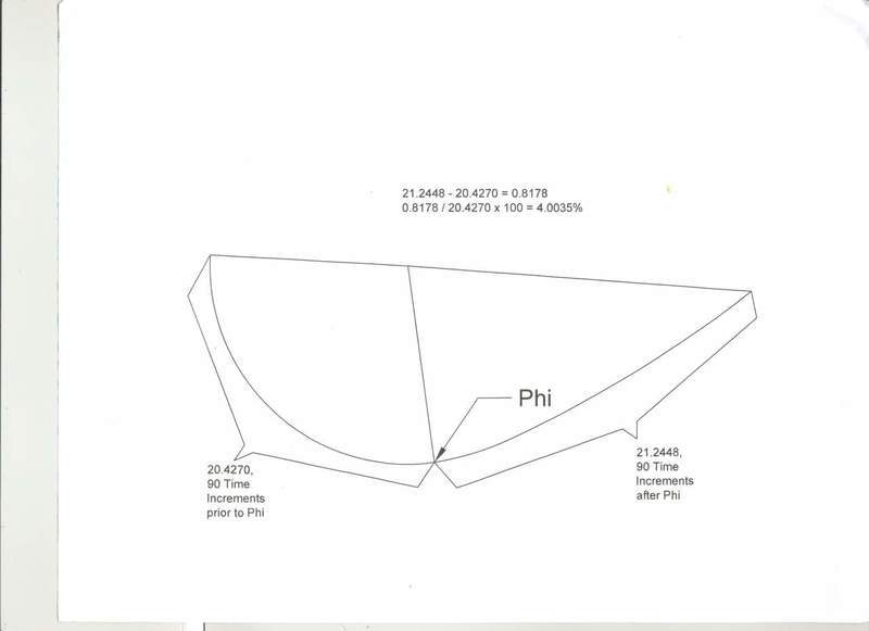

  • #51
k^2 said:
i can build a rotator out of legos and mount it on a cart. I don't need any money invested into it at all, because i can re-scale all the masses.
Oh, and you insist that there is a net force on the system. I'm prepared to show that the system only accelerates when it's pushing off the bumper, and that the force of the bumper accounts for acceleration of cm. No centrifugal force necessary.
The speed of the cm is irrelevant. It's the velocity that's important. It's a vector quantity. The x-velocity is constant as soon as slider separates from bumper. Therefore, no net force. Done. What else is there?
Yes, the y-velocity changes, but you have rail providing normal force to the slider in y-direction. So that's irrelevant. Only the x-direction matters.
I have attached a picture of the pre-phi and post-phi path of the center of mass of the system. This image was made by the AUTOCAD program. Note that the post-phi path is greater in length than the pre-phi length by about 4 per cent. The pre-phi path is just the locus of the center of mass of the system following the path of a circle. The tangential speed is constant during the pre-phi path, except for a tiny decrease in speed due to friction. The centripetal force acting during this pre-phi path cannot increase or decrease the speed of the center of mass. Now look at the point where phi is. Here, the total speed of the center of mass is increasing, demonstrated by the observable fact that the post-phi length is greater than the pre-phi length for same time increment. The total speed of the center of mass is relevant because I am only concerned with the energy consequences of this experiment. Energy is a scalar. The direction is irrelevant. I am interested in a scalar measurement. It doesn't matter if a Tesla electric car is heading north at 100 mph or south at 100 mph, etc. its the speed that determines how much linear kinetic energy it has, not its direction. I am baffled that you don't see it. I repeat, I am only interested in a scalar measurement-- speed, kinetic energy. Clearly, the image shows the speed increased. Isn't seeing believing? This effect is literally a fleeting effect, lasting only
about .4 seconds. This is something you cannot see with your naked eye. It requires a high-speed video camera to capture the increase in total speed of the center of mass. You know, Michelson, who did the famous experiment that measured the speed of light in the so-called ether of space, who tried to prove the existence of this ether by measuring a change in the velocity of light? Michelson was a very skilled optical experimenter and an intelligent person. He took infinite pains to make this experiment, but the results contradicted what he believed should happen. Even seeing no change in the fringe patterns of the light beam did not convince him that the speed of light was constant. This was a case of a man's thinking getting in the way of what he saw. He went to his grave not believing the results of his own experiment.
  • #52
That angle is exactly 6 o'clock, unless there is significant friction between slider and the rail, which would invalidate your test.
The exact path of center of mass is quarter-circle from 9 o'clock to 6 o'clock, and a sine curve from there on after.

  • #53
K^2 said:
The exact path of center of mass is quarter-circle from 9 o'clock to 6 o'clock.
Actually, the path of the center of mass is a section of a circle from 9 o'clock to phi. Remember, the slider doesn't move unitl phi occurs.
  • #54

I can tell you now the above equations will not work. You cannot parameterize the motion of the center of mass with respect to time. The main reason is you are assuming the angular velocity is constant. It is not. If you examine the video carefully, and if you measure the angular displacement of the rotator with respect to the y-axis, frame by frame, you will see the angular velocity is decreasing. You would first have to determine the angular velocity as a function of time. Good luck. The reason why the angular velocity is not constant has to do with the curvature k. Recall from mechanics that k is the measure of curvature or the tendency of a particle to turn as it travels along a curvilinear path, where k = theta/s. The k of the center of mass of the system is constant during the pre-phi path travel of the rotator, but it begins to decrease at phi and reaches a minimum value at 3 o’clock. You would have to find k as a function of theta, where theta is the post-phi angle of the rotator with respect to the y-axis. This would be no easy task. If you can do this, I would like to see it. And to find k as a function of time, you would have to know theta as a function of time, which means you would have to know the angular velocity. So, you would be back to where you started, trying to deterimine the angular velocity as a function of time. There is a lot of inter-coupling going on here. The bottom line is you cannot parameterize the x and y coordinates of the center of mass because the angular velocity is not constant, which is another reason you cannot use the Lagrangian. Time is one of the independent variables used in the Lagrangian. More precisely, using this formalism, you want to end up with a partial differential equation as a function of time with an exact solution. It cannot be done. You would have to use an approximation technique to find a parameterized solution. Fortunately, there is a much easier way to find the motion of the center of mass. You have to forget time as the independent variable and use theta. Using the conservation of linear momentum, you can find the total linear velocity of the center of mass as a function of theta. One reason you can do this, is because the magnitude of the tangential velocity of the center of mass is constant. Recall the expression, v = r w, where v is the tangential velocity, r is the radial distance from an axis of rotation to the center of mass of a body, and w is the angular velocity. It turns out the r is equal to the absolute value of the inverse of k. So, the above can be expressed as: v = (ds/d theta) (d theta/ dt). Notice that as the angular velocity decreases, so does the curvature k decrease in inverse proportion, such that the d-theta's cancel out, and you are left with v = ds/dt. Thus, the tangential velocity remains constant. In the equations I am deriving, they are all based on the independent variable theta. All I have to do is invoke the conservation of linear momentum to find the total tangential velocity of the center of mass as a function of theta. Actually, I have already derived these equations years ago, it's just a matter of using latex to get them posted on the forum, which is taking a lot of time for me.

  • #56
So yeah, got it all worked out. You're right, rotator is decelerating, but at apparently uniform rate, so it doesn't make much of a difference. I've made following adjustments to the above equations.
1) Assumed ω is constant from 9 o'clock to 6 o'clock.
2) Used that omega for x on the entire interval.
3) For y past 6 o'clock I assumed deceleration is constant and made relevant adjustments.

K^2 said:
If anything, ω should increase past 6 o'clock. The electric motor might react to that in a weird way that causes an overall slowdown. I'll take a look at it. And in either case, CM x-velocity is a constant from that point on. So even if the ω(t) changes in time, it's only going to affect the y motion. (Take ω in second part of x(t) to be some effective ω0)
But I highly doubt ω changes a whole lot. There are some symptoms of that that would be plainly obvious. I'm going to see if I can make a video with the curve above plotted over the frame.
There is a problem. In the experiment we did not use a motor. The rotator was "free spinning". We gave it an initial impulse around 11 o'clock, and by its own rotational inertia it rotated counter-clockwise. If you use the image in the attachment I sent to compare with a video of your motorized experiment, it is highly unlikey that it will match. Besides, in my opinion, using a motor just adds an additional complication to the motion of the center of mass. In my experiment I took a minimalist approach, eliminating all unnecessary internal inter-actions. Consider this about the angular velocity. If there was a frame instaneously co-moving with the slider, an observer in this frame would experience a gravitational field because the slider is being accelerated. Albeit the acceleration is not constant, but a complex almost, but not exactly, sinusoidal function of time, nevertheless, there is a gravitational field. Thus, an observer in this non-Minkowski, non-Eucledean accelerated frame would expect "gravity" to slow down the angular velocity of the rotator. He or she would predict it would take more time for the rotator to reach the 3 o'clock position. And it does. We would observe the same effect. Here is why: Since the motion of the rotator-slider system is at non-relativistic velocities, time is essentially invariant across the accelerated frame and our laboratory frame, therefore, we too would measure more time for the rotator to reach the 3 o'clock position-- the same amount of time the observer in the accelerated frame measures.
  • #58
You see the video I posted? See the green curve? That curve assumes NO ACCELERATION of the center of mass.
See how it matches anyways?
See the problem with your reasoning?
Yes, the SLIDER accelerates. Center of mass does not. Where is your centrifugal force?
  • #59
And here is the video.
Notice that at the very, very end, the red dot falls short of the green line. Most likely, that's the effect of friction on the slider. But look! The red dot is MOST CERTAINLY not accelerating to the right, because then it would end up moving to the RIGHT of the green curve. It never does that. That means, centrifugal force from the rotator DOES NOT accelerate center of mass. QED.
Enjoy.
Edit: Yes, just added a little bit of deceleration to account for friction, and it works perfectly now. I even have a little box painted where CM is. If you need, I can make that into a video as well.
Okay, I'm glad its posted on youtube, now others can see the experiment. Here is my response, point by point. You assume w is constant from 9 o'clock to 6 o'clock, but w is constant from 9 o'clock to phi. Look at the video, the slider does not begin moving at 6 o'clock. You stated, "For y past 6 o'clock I assumed deceleration is constant." I'm not quite sure what you mean by that because the y-component of the center of mass is actually increasing with respect to our laboratory frame. There is a sin(theta) going on here, where theta is the angle of the rotator with respect to the y-axis. When theta gets bigger, its sine must be getting bigger, approaching the value of 1. The y-component of the tangential velocity of the center of mass is determined by this sine factor. I AGREE with you that the total velocity of the center of mass in the x-positve direction must remain constant in velocity after phi. You don't have to try to prove that, I agree with you. But now, consider this subtlity. Why does the speed remain constant? The x-component of the tangential velocity of the center of mass is determined by cos (theta). What happens to the cosine when theta goes to 90 degrees? It goes to zero. Therefore, as the rotator continues to rotate, the x-component begins to "shrink". But, we know the total velocity in the x-direction remains constant. Something else must be added to this shrinking x-component of the com tangential velocity in order to keep the total x-velocity constant. What is that something else? The velocity of the slider must be added. The x-component of the tangential velocity of the com decreases, the x-velocity of the slider increases in such a way that the total velocity of the com is constant to the right. Remember, the total velocity of the com is determined by the vectorial sum of the tangential velocity of the center of mass and the linear velocity of the slider. What causes the acceleration of the slider to the right?
Yes, I would like to see the new video and I would like to see your "adjusted" equations.
One final point, one key point. You still need to measure the pre-phi path of the com and compare it with the post-phi path for the same time increment. This is the crux of the
experiment. In the experiment we did not try to predict the structure of the path. We just measured it. This path actually is an "invariant" structure. You don't even need a reference system to measure it. All you need is an arbitrarily defined unit measure, then you measure the pre-phi and most phi distance for the same time increment (you still need time), and then compare the two. Its the whole point of the experiment.
  • #60
Wow, you are one confused person.
Velocity in the x-direction does not have to "shrink". The ONLY way that the x-velocity can change is if there is an x-Force applied to the CM. There is no such force here (other than friction). That is entirely consistent with the behavior.
You took a simple system of slider/rotator rotating around CM (red dot), and added a constraint in the y-direction (rail). Then you tried to explain what happens, and you explained it completely wrong, because you don't understand constraints. No surprise that in your wrong model you need an extra force to make it work. That doesn't mean it actually exists.
And yes, slider begins to separate from bumper at exactly 6 o'clock, unless you did a crappy job building a rail, and it gets stuck. The motion of the slider is easy enough to describe as well.
Would you like me to also plot slider's position over that video to prove that my model works EXACTLY to describe the motion of slider, rotator, and the CM without having to invent any new forces?
I already posted to you proof that the model I derived is correct. Your "proof" that there must be a force is that your incorrect curve doesn't match video. All that proves is that you screwed up.
