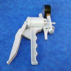

manp said:
I want to create a mechanical vacuum (semi not necessarily complete), I've heard the easiest way to create one is by expansion (basically expanded a pump). But is this also the easiest way physically, as in takes the least amount of energy? Or is there any other 'mechanical' way possible for this (excluding the use of external electricity or chemicals). Any pointers would be appreciated.
Would a hand vacuum pump like this work for you? I've use these in the past to pull a modest vacuum...
https://www.amazon.com/dp/B003B3WC3Q/?tag=pfamazon01-20

Thanks all, I think I am going to try the hand pump Berkeman suggested, hopefully itl work.
