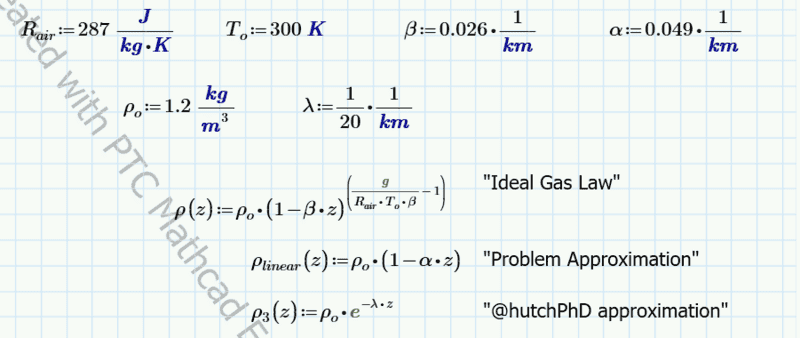

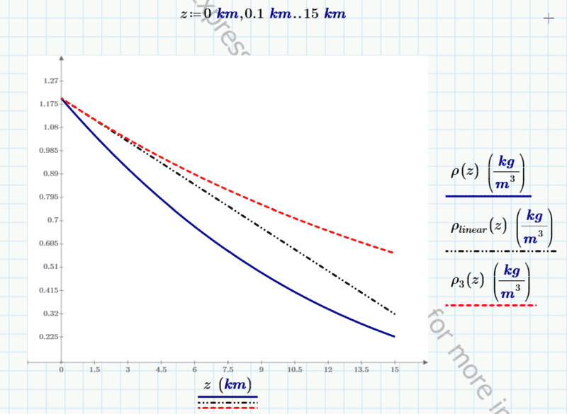

Here are all three proposed density functions with each other:
If you are going to use a nonlinear function to get a numerical solution, just use the physical model surrounding the problem...

My method comes up with 11 km.
I used a spreadsheet to calculate the densities at every km using your formula. Then to calculate the moles based on:
density * 850 m^3 / 29 kg/kmol
That is the outside moles in 850 m^3 for that density (at that height)
200 kg / 29 kg/kmol = 6896 mol.
So the internal mol is the outside mol (from the density calculation) - 6896
I calculated the temperature at every km using your formula.
Since pressure inside =pressure outside, and the volume is the same 850 m^3, the ideal gas law is just concerned with the number of moles, times the temperature. If I multiply I have the columns with the moles at every altitude. I have the column with the outside temperature. I know the inside is 373 K.
When the outside temperature at an altitude times the number of moles at that temperature is equal to the inside temperature times the same number of moles minus 6696.
AT 11 km, the air density is 0.5532 and the temperature is 214.2 K. That density is 16214 moles of air in a 850 m^3 volume. Inside is then 9317 moles of hot air at 373.
373 x 9317 is approximately equal to 214.2 x 16214
They are not exactly equal. You could easily take the approximation closer. I used 1 km increments in my spreadsheet.
This agrees with the answer I saw on another page. It was far easier to use a computer than to solve the very complex looking equation for height. A better math whiz might look at it and see the answer.
But ultimately, I think the agreement shows you could just look at the balloon volume net mass, and know that it has to be less by the same amount as the load.
