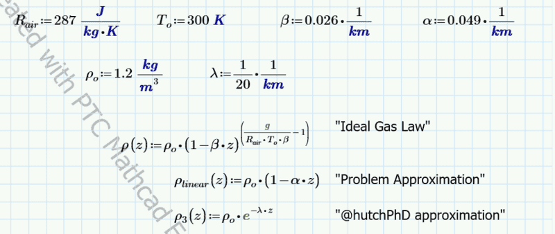

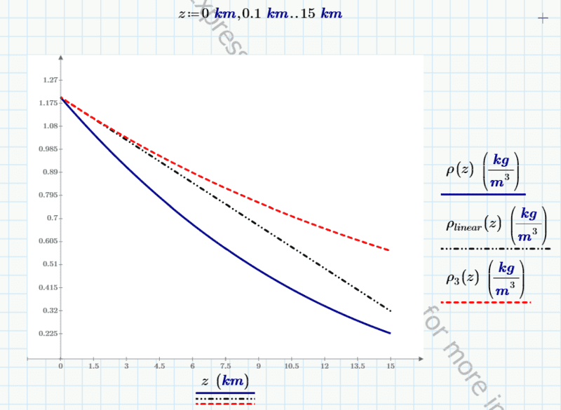

This equation can be written as:
$$\rho' + \frac{g}{RT} \rho = 0$$.
It is a first-order linear ordinary differential equation of the type:
$$y'(h) + a_0 (h) y(h) = 0$$, which has solution ## y(h) = k \cdot e^{-A(h)}##, with ##A(h) = \int a_0(h) dh##.
Since, in this case, ##A(h) = \frac{g}{RT} h##, we have:
$$\rho (h) = k \cdot e ^{- \frac{g}{RT} h}$$
What do you think?

Following your advice, I arrive at the equation:
$$\rho' T + T' \rho+ \frac{g}{R} \rho = 0 $$, from which:
$$\rho' T + T_0 \beta \rho + \frac{g}{R} \rho = 0 $$. Therefore:
$$\rho' T + \left(T_0 \beta + \frac{g}{R} \right) \rho = 0$$, whence:
$$\rho' + \frac{1}{T} \left(T_0 \beta + \frac{g}{R} \right) \rho = 0$$.
Following the procedure of the previous message, we have:
$$A(h) = \int \frac{1}{T(h)} \left(T_0 \beta + \frac{g}{R} \right) dh = \left(T_0 \beta + \frac{g}{R} \right) \int \frac{1}{T_0(1 + \beta h)} dh = \left(T_0 \beta + \frac{g}{R} \right) \frac{ln |1 + \beta h|}{T_0 \beta} h + c$$. Finally:
$$\rho (h) = k \cdot e ^{-\left(T_0 \beta + \frac{g}{R} \right) \frac{ln |1 + \beta h|}{T_0 \beta } h + c}$$.
What do you think?

Ok, I'm fixing the sign error.$$\rho' T + T' \rho + \frac{g}{R} \rho = 0 $$, from which:
$$\rho' T - T_0 \beta \rho + \frac{g}{R} \rho = 0 $$. Therefore:
$$\rho' T + \left(\frac{g}{R} - T_0 \beta \right) \rho = 0$$, whence:
$$\rho' + \frac{1}{T} \left(\frac{g}{R} - T_0 \beta \right) \rho = 0$$.
$$A(h) = \int \frac{1}{T(h)} \left(\frac{g}{R} - T_0 \beta \right) dh = \left(\frac{g}{R} - T_0 \beta \right) \int \frac{1}{T_0(1 - \beta h)} dh = - \left(\frac{g}{R} - T_0 \beta \right) \frac{ln |1 - \beta h|}{T_0 \beta} h + c$$. Finally:
$$\rho (h) = k \cdot e ^{\left(\frac{g}{R} - T_0 \beta \right) \frac{ln |1 - \beta h|}{T_0 \beta } h + c}$$.
Is it really necessary to trace the ODE back to a separable variable differential equation? Is my procedure wrong? I can't do it directly, however...

Okay. I get to the equation:
$$T \ d \rho = \left(T_0 B - \frac{g}{R} \right) \rho (h) dh$$
I don't know how to handle this equation by integrating both members....
  • #120
The method of separation of variables... All factors involving ##\rho## on the left, and everything involving ##h## on the right.
$$ \frac{d \rho}{\rho} = \left(T_0 \beta - \frac{g}{R} \right) \frac{dh}{T(h)} $$
