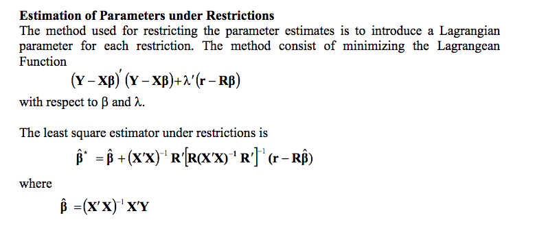

The subject of linear regression given coefficient constraints (aka restricted regression) has been studied (see, for instance, section 5.6 of Searle, "Linear Models") and there are implementations (e.g. SAS RESTRICT statement). There are some youtube videos that may be relevant (e.g. https://www.youtube.com/watch?v=K-PsdZDaNDE). I have no experience with it, but I assume that the mathematical/statistical approach is valid.

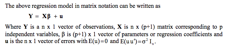

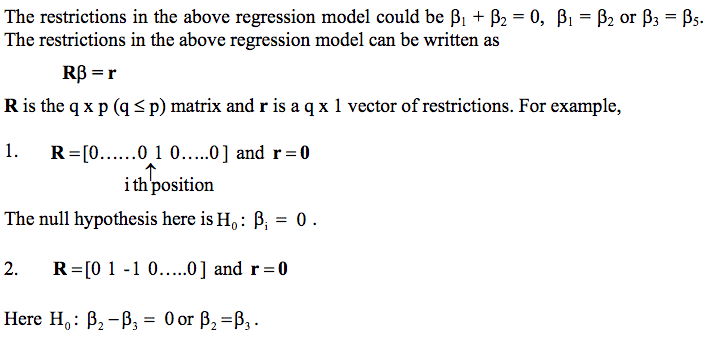

I found this, do you think this would work for my problem, instead of setting the first coefficient myself, or instead of putting the known point in the dataset, if I instead do a regression analysis like this, would it not increase my overfitting?

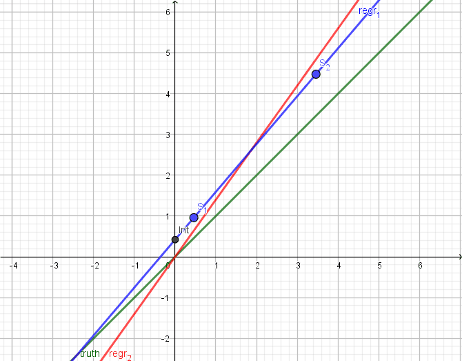

So I did a test, I calculated the average residual over all models, and the average difference between the true intercept and the fitted intercept.
So the answer with the subtraction method is much lower to the true intercept, and also a lower residual, but I don't think I can trust the lower residual.
With this information in mind, do you still agree to include the intercept in the measured data points and fit normally with no restrictions?
Thank you so much, the advice I am getting has been very VERY helpful
This is just the wrong direction to go in. If that is not a measured experimental data point, then it is a theoretical point. If it's a theoretical true value, why only include it once? Why not two or three times? Or 20 times? Pretending that the theoretical intercept is an experimental sample data point is the wrong way to go.
You should either give up the theoretical intercept and apply a regression model allowing it to freely determine the intercept, or you should use a model that forces an intercept of (0,7).
I would not recommend ignoring the theoretical known value, no matter how it changes the statistical results. I see no reason to prefer accurate statistical measures of a known invalid model. I would prefer modified statistical measures of a known valid model.
