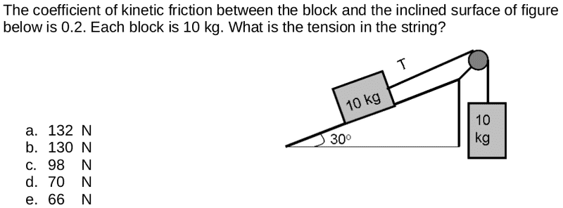

I tried solving the question below, but I get a different answer than any available inthe m multiple choice.
Netwon's Second Law
I get 82N. http://hyperphysics.phy-astr.gsu.edu/hbase/incpl2.html gives me 82N for the tension as well. Am I incorrect? Apparently, the answer is E.
The value that you calculated looks correct for the given problem statement.
