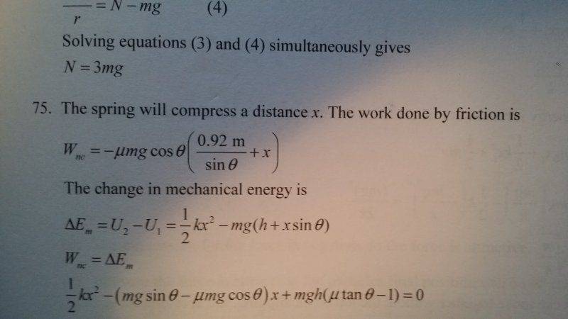

I solved for work of friction, the work of gravity and the work of spring (d is vertical distance of 92cm and x is the distance of compression)[/B]
http://puu.sh/bTjoU/221afafc3f.png
I then used the conservation of energy law to piece together my 3 equations
http://puu.sh/bTjw6/e9c0236b16.png
apparently my equation didn't match with the answer's. Can someone please tell me why?? and what did I miss??
Looks OK to me - what was the model answer?
http://puu.sh/bTRBF/53f9460841.jpg
This is the textbook answer, could it be that the textbook is misprinted?
Probably a typo.
Either put a slash between μ and tan(θ) or change tan(θ) to cot(θ).
