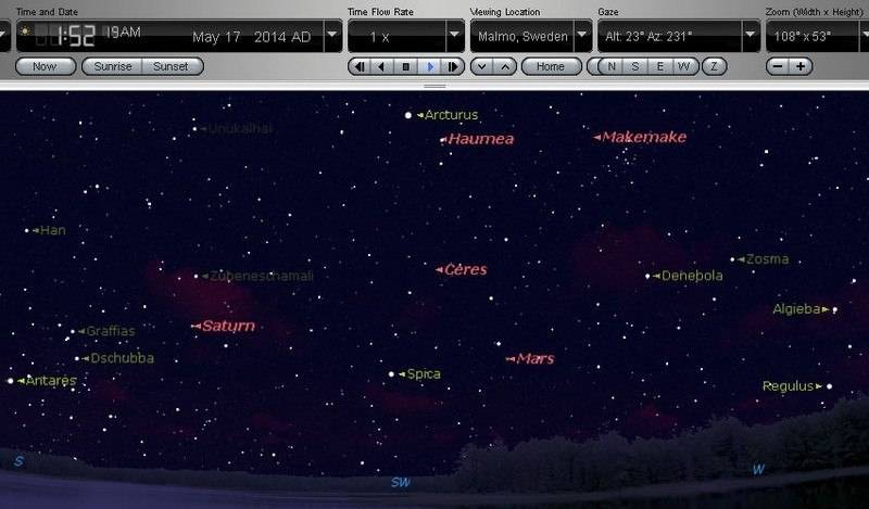

Can you estimate the direction better? Saturn was SSW at 17 degrees altitude at the time, but Mars was WSW at 15 degrees altitude. I think it is more likely that it's Mars (that was my first thought when I saw it too).
Almost directly between them and slightly dimmer than Saturn (Mars is brighter than Saturn) is the star Spica. Above that a good fraction of the sky is the star Arcturus, which is about as bright as Mars. See below:
Planetarium software screenshot of the southern sky at 1:52 AM on May 17, 2014, viewed from Malmo, Sweden, with labelled stars and planets including Saturn, Mars, Spica, Arcturus and Antares.
  • Planetarium software screenshot of the southern night sky from Malmo, Sweden on May 17, 2014 at 1:52 AM, showing labeled stars and planets including Saturn, Mars, Spica, Arcturus and Antares, with compass labels S, SW and W along the horizon.
Thanks a lot, Russ! I've also had second thoughts since I posted, thinking if it might be Mars instead. Good idea about the direction! I will go out on my balcony (where the picture was taken) with a compass in a while, I think I can get a better estimation. The weather is very nice at the moment over here, and hopefully it will be a clear night. If it is, I will go out tonight and try to repeat the observation. I'll also give it a try with my cheap binoculars.
Ok, I did an estimation of the observation direction with my compass and with the help of my balcony photo above. My compass says 245 degrees, and that is pretty much WSW according to this compass card. I had to check with the compass card, it was a long time since I used a compass :smile:.
EDIT: I will try to make a simple sextant for an altitude estimation tonight. I hope for clear skies...
A program you can use to help you learn the stars and objects in your local night sky is Stellarium. It's free on the computer, and I believe Android based devices, but iOS costs a few dollars. It's pretty amazing actually

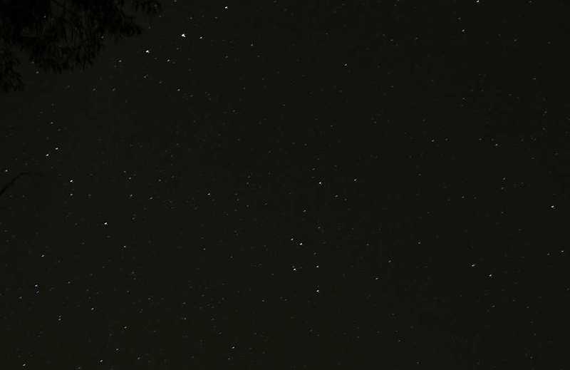

Dennis,
your first pic in post #12 is still just showing an out of focus image of a star or something
You need to experiment a bit and learn how to focus in a pinpoint star light source so that you produce pinpoint star images in the photo like this ...
Night sky photo with many small, sharp white star points scattered across a dark background, with a dark silhouette of tree branches in the upper left corner.

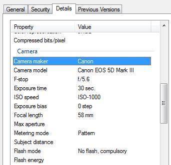

The stars in this image I did are just on the verge of having tails because of the 30 second exposure time here's the camera and its settings...
Windows file Details tab listing EXIF metadata: Camera maker Canon, Camera model Canon EOS 5D Mark III, F-stop f/5.6, Exposure time 30 sec., ISO speed ISO-1000, Focal length 58 mm, Metering mode Pattern, Flash mode No flash, compulsory.
get a good star field pic where you can identify any planets and brighter stars and we can proceed from there :smile:
cheers
Dave
  • Night sky photo with many small, sharp star points scattered across a dark background, with a dark tree silhouette in the upper left corner.
  • Windows file properties Details tab showing camera metadata: maker Canon, model Canon EOS 5D Mark III, f-stop f/5.6, exposure time 30 sec., ISO-1000, focal length 58 mm, metering mode Pattern, no flash.

davenn said:
1) you are not going to be able to do star/planet photos as I suggested in my last post because
the camera is pretty much totally auto.
you will always get blobs for stars rather than pinpoints because the camera only has auto focus with no manual focus option.
This means you cannot focus on stars or planets as there is nothing for the auto focus to lock onto.
Thanks for checking it up! No, I can't control the focus manually. I'm painfully aware of it :smile:.

Hi again everybody!
Thank you very much for the additional advice in post #19, davenn! I will save the info in this thread and go over it again when I get closer to my scope and camera purchases. Camera and scope advice is very good to have, particularly for novices like me :). I will definitely return to the forum for comments and advice regarding which equipment I plan to purchase. Thanks again!
Well, my story just ain't over yet...:smile:
Last night when I was walking home, I looked up at the sky and I saw my object of interest again. I can swear it was laughing at me, because I could hear the words "you think you know me, but you don't". No, seriously, I also saw some other objects too in the vicinity, and I thought about russ_watters' post #14...

...so I couldn't resist making another observation using this info. I fetched my compass and sextant, found a pretty good observation spot and took care looking at the sky (I did not take any photos). I made a sketch of what I saw, and made additional azimuth measurements, in order to compare with the Stellarium data. Here's my sketch (it's only basic and approximate, and I hope it's understandable) and another Stellarium screenshot to compare it with:
My identifications:
(1) - Arcturus (this object was very bright)
(2) - Spica (visible, but definitely dimmer than the other objects
(3) - My object of interest (very bright, my conclusion is that it is Mars, and it looked very much like Mars looks in Stellarium)
(4) - Saturn? (it seems so, yet it was very much brighter than I thought)
Is Saturn the Night Object in Photos?
My conclusions so far:
  • The object of this thread (my object of interest) IS Mars, not Spica.
  • I need more stargazing and navigation experience.
  • I trust my compass (it's good enough).
  • My improvised sextant is too crappy to rely on.
  • Stellarium is a good program.
  • My camera is not appropriate at all for these kind of things (which I've already understood).
  • I've found a new, pretty good observation spot pretty close to my home.
I will also take some photos of object 4 (Saturn?) when the weather here gets better, I simply have to see what the photos will look like...
