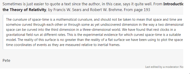

Here's what I read in a closed thread asking about the meaning of spacetime curvature:
The curvature of space-time is a mathematical curvature, and should not be taken to mean that space and time are somehow curved through each other or through some as yet undiscovered dimension in the way a two dimensional space can be curved into the third dimension in a three-dimensional world.
So does that mean if we were able to move to some spot "way above the earth/sun/distant galaxy" where we could watch light and trace it from a distant galaxy (which is otherwise hidden from us) pass around (?) the sun and hit our telescope, it wouldn't literally curve around the sun as is depicted in so many laymen's physics books? (I'm describing the Eddington experiment of course.)
The curvature of spacetime is more than just mathematical. It is physical. In curved spacetime the rules of flat geometry fail. Triangles can have interior angles different from 180 degrees. Straight parallel lines can intersect. Lines can continuously curve away from each other without getting further apart. Etc.
All of those non-flat geometrical features can be physically measured, so the claim that it is just math is incorrect.

Here's the link, it's post 4: https://www.physicsforums.com/threads/what-does-curvature-of-spacetime-really-mean.196359/
I guess that agrees with what folks have posted here?? It probably gets into speculation to ask why it's NOT a curvature into a fourth spatial dimension.
I have not heard of that book before, so I cannot vouch for its accuracy. I agree with the fact that it is not necessary to think of "some as yet undiscovered dimension", but disagree with the "mathematical curvature" bit.
The surface of the Earth is not just mathematically curved, it is physically curved. If you start at the north pole, walk straight south to the equator, turn 90 deg, walk straight east 1/4 of the globe, turn 90 deg, and walk straight north to the pole then you will find you are facing 90 deg off from where you started. Thus, the interior angles of this triangle sum to 270 deg, not 180 deg. That is how we can know that the surface of the Earth is physically curved, it does not follow the geometrical rules of flat surfaces. This physical curvature can be physically measured with physical protractors and other physical measuring devices.
Similarly the physical curvature of spacetime can be measured with protractors, accelerometers, rulers, clocks, etc. This is the physical geometry of the universe as actually measured by physical devices in the universe.
