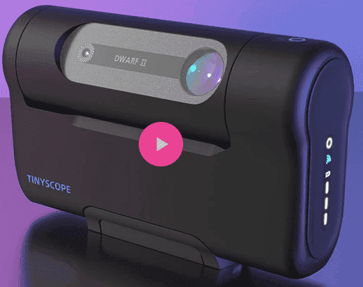

I think this is improbable in the extreme, since the mechanical tracking servo component is pretty much the core of the device:
Photo of the TinyScope DWARF II, a black compact telescope with a glass lens on top and a pink play button overlaid in the center of the image.
IOW, without the mechanical ability to track sky movement, this device would not exist at all. It would be ... just a camera.

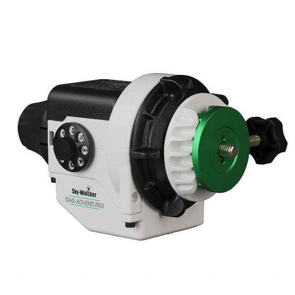

So, maybe a better comparison would be the original Sky Watcher Star Adventurer that retails for USD $350.
https://optcorp.com/products/skywatcher-star-adventurer-photo-package-s20520
Sky-Watcher Star Adventurer equatorial mount, white and black body with a green-anodized gear wheel and a black knob on the right, and a front dial labelled with star and power symbols and OFF.
It doesn't have GoTo capabilities, but then again the DWARF II doesn't have GoTo capabilities either (as far as I can tell), so this is probably a better comparison anyway.
