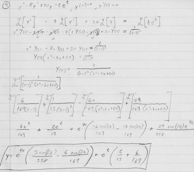

y"-8y'+20y=tet, y(0)=0, y'(0)=0
I need to know if I made a mistake in getting to the step below:
L-1{ 1/[(s-1)2(s2-8s+20)] }
because when I solve that, I get something pretty gnarly..

Show us how you got to that step.
So y(t) = L-1(Y(s)) = L-1(1 /[(s - 1)2(s2 -8s + 20)]
Break up the right side using partial fractions, and then you can take inverse Laplace transforms of them separately. This is how you should decompose the right side.
$$ \frac{1}{(s - 1)^2(s^2 - 8s + 20)} = \frac{A}{s - 1} + \frac{B}{(s - 1)^2} + \frac{Cs + D}{s^2 - 8s + 20}$$
When you figure out A, B, C, and D, check your work to make sure you haven't made an error. Then we can talk about the final step.
So I was doing it right.. The answer was kinda big so I thought I made a mistake somewhere.
Jeff12341234 said:
So is that right?
Yes, it is. Well done.
Jeff12341234 said:
So is that right?
In your post just before the one I'm quoting, you showed the solution you found. I assumed that you had checked your solution to verify that it works.
