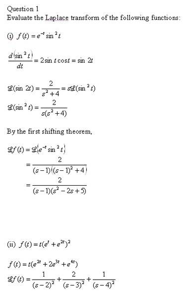

noobish
I wish someone would help me to verify my answer and working. I don't have the answer for the question. :frown:
http://www.mrnerdy.com/forum_img/laplace.jpg
Is there a better working method?
My browser shows that your image is broken. Can you either post it as an attachment or type it up in LaTeX?
im sorry. I've fixed it. :)
