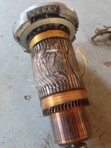

It is a fact that voltage is linear with velocity.
For DC motors it's the basic equation, open circuit voltage = KΦRPM with K being a constant for that particular motor. and Φ being flux.
At least until the armature conductors get flung out of their slots as above.

Thank you jim for the picture, It was really interesting to see this. Just a question about it, So this thing happened because the ions core wanted to move in a circular motion inside the wire but the wire is stuck to both ending of the machine... ?
That damage happened because the motor spun too fast and centrifugal force threw the copper conductors out of the spinning rotor into the airgap space between rotor and stator where they got wedged and chewed up . Purely a mechanical not electrical or magnetic phenomenon.
That happens when a series wound motor gets disconnected from its load with full voltage applied.
That one was in an electric car, the guy floored the accelerator while transmission was in neutral.
