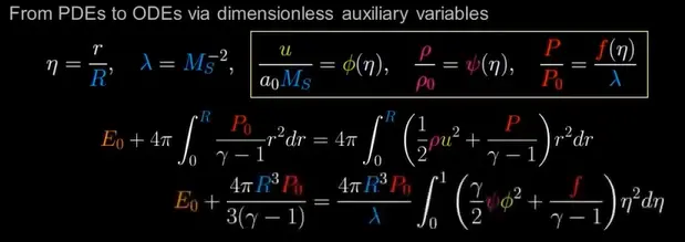

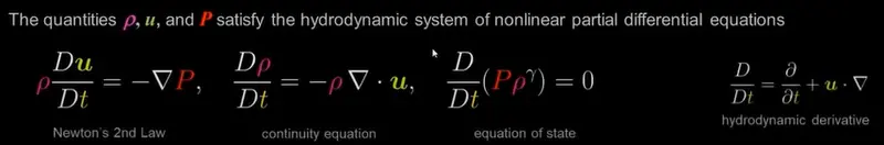

The first step that confuses me is this:
I fully understand the left hand side, as he just found the value of the integral, but what confuses me is the right hand side and specifically the ##\frac{\gamma}{2}\psi\phi^{2}## term. I'm pretty sure that what he did is made some substitutions and moved the constants ##\frac{4 \pi R^{3}P_{0}}{\lambda}## out of the integral, but when I do that I can't get those constants to come out of the integral.
What is a0 (it is some sort of velocity)? If Ms is the mach number, I am unsure why one can pull it outside the integral.

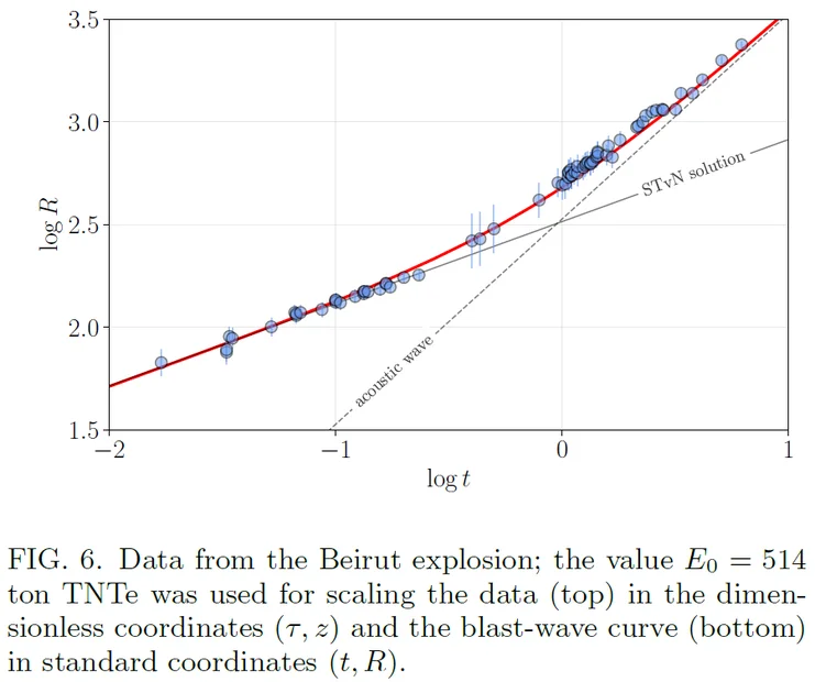

Diaz has a paper on archive.
https://arxiv.org/pdf/2110.09488
It assumes that you already know a lot.

Thanks for citing the Diaz & Rigby paper. We had a poster some time back who vehemently insisted that a blast-wave shock-front could propagate at the speed-of-sound ##c## and cited data from the 2020 Beirut chemical explosion to back his claim. But the analysis in this paper clearly demonstrates that the Beirut shock front traveled supersonically and only approached ##c## ("acoustic wave") as ##t\rightarrow\infty##:

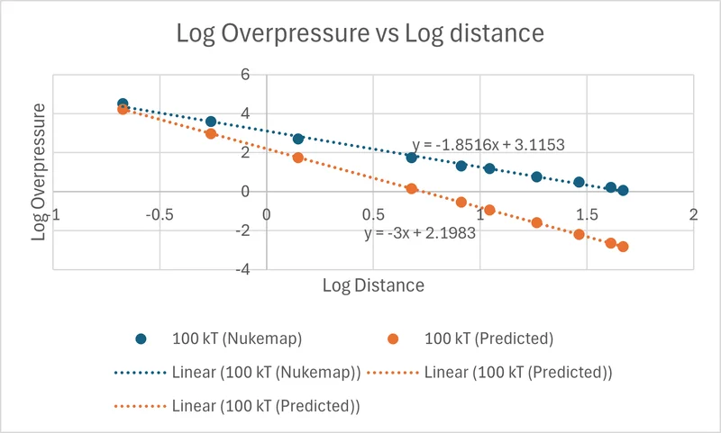

What nukemap? Overpressure going as E/R3 is common result.

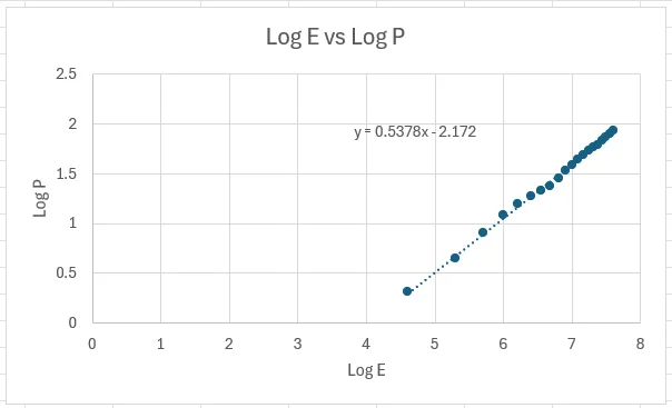

This one by Alex Wellerstein. The dimensional analysis makes sense but plotting yield and overpressure on a graph shows that it isn't linear:
Taking the logarithm of both sides and checking the gradient of the line makes the non-linear trend of the line even more clear:
It looks more like a square root relationship rather than a linear one based on the line
Edit: The sample points were taken 4.78km away from the blast site, if that information is relevant

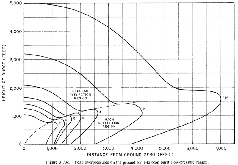

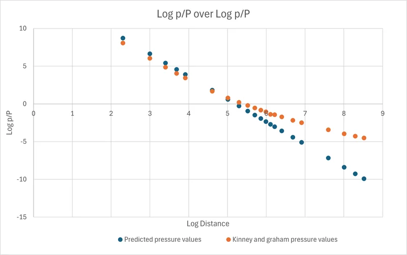

You have nukemap and you have an equation. Have you tried plotting nukemap using the equation?
The distance matters.
Does nukemap have mach reflection?
Yeah, I've done the same for distance and the equation also disagrees:
The overpressure seems to be decreasing similarly to the inverse square law but my model predicts a cubic decrease.
It does, that's why it can also model airbursts aswell
In the language of the paper, is nukemap using the STvN solution or something more complicated? One also needs to think about the error bars of the synthetic data.
To confirm, mach reflection is turned off in the nukemap numbers?

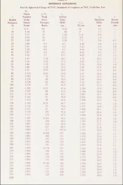

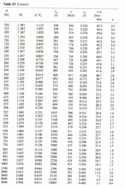

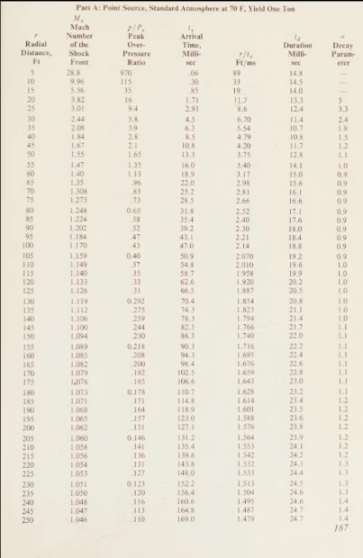

The paper is describing spherical explosions. So you are calculating two different things.

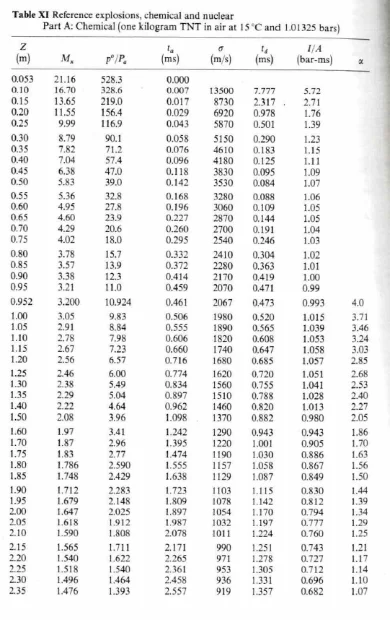

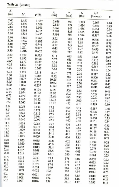

Do you have access to the book by Kinney? The first edition has a table for a one ton explosion as a point source and as a spherical charge. The second edition has a table for a 1 kg and a 1 kt tnt explosion. Try comparing the code and the paper to either of these data sets
Do mach reflections affect the overpressure that much? Even when the explosion is on the ground? I reasoned that the effects would only be some sort of scaling factor as the solution that Diaz came up with was able to model surface bursts by dividing the calculated yield by 1.8 to account for reflections
Unfortunately not, could you link the table here by any chance?
Give me a day or two.
