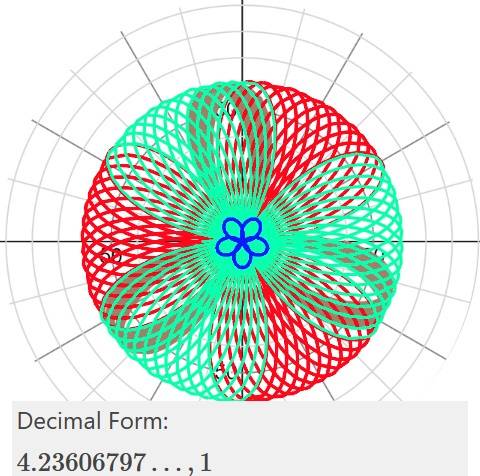

ii. Is there anything in the way of online tools, such as graphing or analysis applications, that will allow me to understand
what this is? The attached pic is a simple sine function on a graphing website but I am unsure as to the proper way to graph.

What is ##\phi##? What are ##a,b,c,d##?

It looks undefined.

Have a look at:
