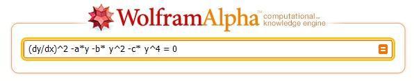

. . . ohhhhhh . . . even easier . . . just a few seconds to have the explicit formula :
I let you try WolframAlpha and see the result :smile:
