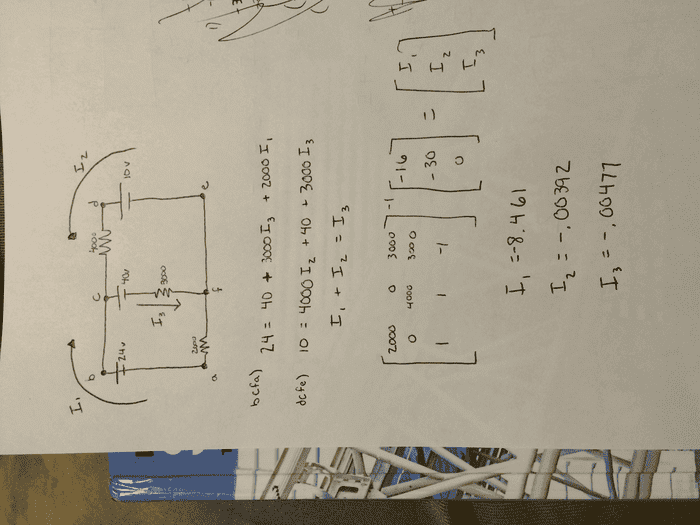

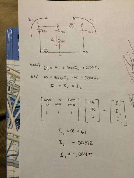

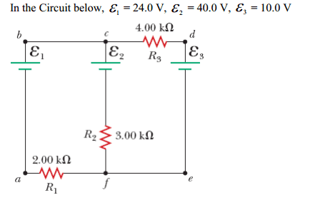

Find the currents going through each resistor.
V=IR
[/B]
I have the problem worked out and I can't find any errors in my work. The issue is that my professor has:
I1=-.0843
I2=.086
I3=.0017
However my physics professor is notorious to make errors in class and right sloppily, so I don't entirely trust his solutions. Can you find any error in my work/confirm my results? Sorry about the picture being sideways.
Sorry, struggling getting the picture up...in the meantime my answers are:
I1=-8.461
I2=-.00392
I3=-.00477
Your answers are missing units, making it difficult to say whether they are numerically correct. You'd definitely lose marks though for not showing units.
Assuming your results are in Amps then I2 and I3 look to be correct numerically, but I1 is not... it's got the wrong order of magnitude. So check your calculation there.
Yes, sorry about that. They are in amps. I missed the scientific notation in my matrix. Should I1= -8.461e(-4)?

Yes, that's right.
