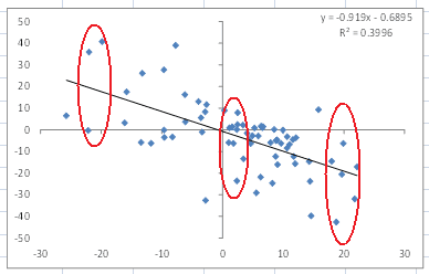

Hi,
Please see the attached Excel file.
I have a sample of 70 data pairs. The correlation between X and Y is -0.68. The OLS regression coefficient is statistically significant as shown in the file. However, with a R^2 of 0.40, I am not sure if my model would be good enough to forecast Y.
Can you please take a look?
Thanks.

musicgold said:
What is making me nervous is the relatively low value of R^2 of the regression line. I am not sure how confident I should be about the predictions by this model.
As you can see in the graph, knowing the x-value won't give a reliable prediction for y. It is better than not knowing the x-value (that's what the non-zero correlation tells you), but the spread of the datapoints is quite large.
If you want to determine the predictive value of your model, set aside a portion of your data to use for validation (or collect new measurements and use them for validation). I agree with mfb that the model probably won't have a great deal of predictive value.
What do you mean by this?
See the highlighted areas in the attached image - very similar x-values (within each of them), but a large variation in y. Your prediction can be something like "it is probably within that y-range", but not better than that.
So should I go back, take only 60 of the 74 points and run the regression analysis again and see how the new model predicts the Y values for the remaining 14 X-values?
If yes, how should I go about selecting the 60 points, randomly?
