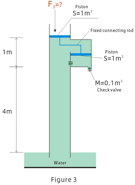

Personal interests aside, I've run into another fluid pressure problem I don't understand.
F=ρgsh,ρ=1000,g=10。
Neglect gravity other than that of water; neglect friction.

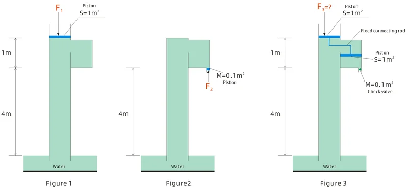

F1=ρgsh=1000*10*1*(1+4)=50000 N;
F1=ρgsh=1000*10*0.1*4=4000 N;
F3=50000-4000=46000 N?

I agree that the downward force (suction) from the water on the first piston (##F_1##) is 50000 N.
I agree that the upward force (suction) from the water on the check second piston (##F_2##) is 4000 N.
Before we can calculate ##F_3## we need to decide what ##F_3## is. Is it the force of suction on the top piston alone? Is it the net force of water pressure on the two piston assembly? (I assume the latter).
What does the check valve do? Does it prevent air from entering but permit water to exit?
Importantly, what is the pressure in the sealed chamber between the lower piston and the check valve?
I find it easier to approach this problem by considering the external force that holds the piston assembly in place. What [range of] external force values would permit the system to remain in equilibrium?
Big hint: When I look at the drawing, I see a sealed chamber with a piston. That piston is not going to move unless the check valve is forced open or cavitation occurs.

The intended meanings of F1, F2 and F3 are not clear. Are they meant to represent:
- the force of the water on the piston?
- the force of the piston on the water?
- the external force needed to keep the piston in equilibrium?
- something else?

In Figure 3, water will inevitably flow out through the check valve. I added the check valve to prevent air from mixing with the water in the pipe cavity, ensuring the effect of M=0.1 square meters remains unchanged. Overall, water descending from the top will flow out through port M. The magnitude of the resultant force is likely the gravitational force of the water over this 1-meter height difference. What I want to understand is how to analyze and calculate this, and how to map the parameters in the formula to specific numerical values.

F1 and F2 represent the pressures exerted by water on the piston, respectively, while F3 is the resultant force exerted by water on the piston.

Did you mean to say that ##F_3## is the resultant force exerted by water on the assembly that includes both pistons? That is to say that ##F_3## will be the sum of the forces from water pressure on each of the three piston surfaces.
It would have been cleaner phrasing if you said that "##F_1## and ##F_2## represent the pressures exerted by water on the respective pistons". When you say "the piston" and then add "respectively" afterward, it sounds awkwardly like you are pairing a single piston with two forces.

You have not described the situation adequately.
Are we to assume that the piston assembly is held in place until a preset moment when it is released?
Edit: I think this is what you have in mind.
Your expectation is that the piston assembly will descend and that water will squirt out through the check valve with a non-zero velocity that may or may not increase over time. Is that correct?

Assume Figure 3 depicts the initial static state, where the top of the left piston is secured by a rope. At the instant the rope is cut, what is the magnitude of the resultant force F₃ exerted on the piston by the freely falling water within the pipe? Although the 4-meter-deep water at the bottom remains stationary, it continuously exerts a steady pulling force on both pistons. Therefore, I believe its contribution to F₃ cannot be ignored.

It exerts an upward force on one piston and an equal downward force on the other. The water in the 4 meter tube does not move, even after the rope is cut. Why can it not be ignored?
How about we begin with a simple calculation. What is ##F_3## before the rope is cut? Assume that the [gauge] water pressure at the check valve is zero. So that the valve is just on the verge of allowing water to leak out. Meanwhile the motionless right hand piston is supporting the water between check valve and piston just like in the famous inverted water glass trick.

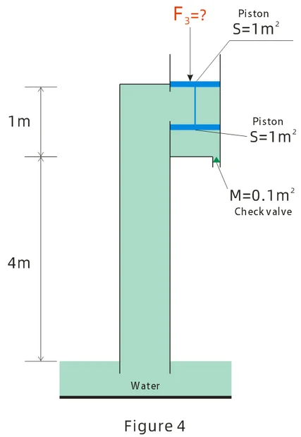

It is equivalent to Figure 4, and it appears that F₃ = ρgsh = 1000 × 10 × (1 - 0.1) × 1 = 9000 N is correct.
I am seeking a method to draw water from the top of a pipe while minimizing gravitational changes in the water within the pipe. This concept is quite challenging, but I believe it is feasible.

I just thought of another new structural form that seems closer to my target requirements. I'm currently drafting the analysis diagram.

The calculation is incorrect because: ( From Post #1 )
Figure A calculates the static force F1 correctly om the piston with the one column of water.
Figure B calculates the static force F2 on the valve correctly with the one column of water.
Figure C is a s new system, with two columns. It must be analyzed separately in its own.

Label all that needs to be labelled: L1 = 1m, L2 = 4,m Piston A, Piston B, etc to avoid confusion.
Label a datum level, where pressure is allocated to be 0.
Use a ∇ on that surface.
Then posts such as #3, from @Lnewqban, will not be necessary.
Is F3 the restraining force or the force of the pressure on th piston(s). Unclear.
A flapper valve should be added to the bottom piston, that allows water to enter the second chamber column when the piston ensemble is moving upwards.
1. The implied external static force F3 on piston(s) is different slowly moving up, than moving down.
Water ,moves slowly out the valve..
2. With the piston ensemble dynamically moving down without external restraining force, the water moves with a velocity out the valve. A pressure differential now exists across the valve.
3. Was a spring force of F2 added to the bottom valve M as surmised by the calculations. Where did this come from except by add hoc magic? ( Transferring over form Fig B is not allowed for this new system )
4. The lengths of the bottom piston within the 1m second column is not given.. As such, the pressures acting on the top not the bottom of this piston are not calculable. Add a n L3 or L4.
5. The stress within the connecting between the two pistons will need to be calculated. Is it a rope, in which case the top piston might not exert a force ( no compression, maybe tension ) on the bottom piston when moving downwards . If rigid, is it in compression, or tension?
Your system is more complicated than realized.

My objective is to calculate the downward resultant force exerted by water on the piston under Earth's gravitational conditions. As shown in Figure 1, the resultant force when an external force pulls the piston upward can be readily determined without analysis. To avoid interfering with the analysis, the check valve within the pipe is not labeled. To simplify calculations, the gravitational forces of all components except the water volume are neglected, and friction is also ignored. However, the resultant force calculation for this structure matches that in Figure 4. Based on the established objective, this model ultimately failed to meet my requirements.
You are seeking to design a pump?
It is indeed quite challenging to design a pump that raises water without requiring power.
vdance said:
I explicitly stated in the question that the weight and friction of all components except water are negligible. Are there any other external forces acting on this system?
If the answer does not involve calculating the 46,000 N force generated at a height of 4m (50,000 - 4,000) nor neglecting the 4m height component F₃ = ρgsh = 1000 × 10 × (1 - 0.1) × 1 = 9000 N, I cannot understand how to proceed with the calculation.
For a massless piston assembly subject to no external forces other than water pressure, the calculation for ##F_3## is immediate and obvious.
##F_3 = 0##
It cannot be otherwise since the momentum of the piston assembly is constant and zero.
vdance said:
It is equivalent to Figure 4, and it appears that F₃ = ρgsh = 1000 × 10 × (1 - 0.1) × 1 = 9000 N is correct.​
That is manifestly incorrect. When summing forces it is important to be mindful of what those forces act on.
You must not rush to show us formulas. You must explain in painstaking detail how those formulas are derived. Because that is where your errors exist. That mythical 4000 N is a force that does not act on the piston assembly. It is also a force that does not exist in the scenario you are evaluating.
[The original problem statement indicates that gravity on the piston assembly is to be neglected. So the piston assembly is weightless. If it is weightless, it is also massless]
You may have some misundestandings - even about the forces in Fig. 1. Try working through this:
Consider the simple Fig. 1 setup. Assume the piston is of negligible weight and is stationary and in equilibrium. Take atmospheric pressure as 101kPa (=101,000 N/m2).
Assume friction, surface tension and adhesion forces can be ignored. There are then three forces acting on the piston:
__________________
1) The force due to the hydrostatic pressure of the water acting on the bottom of the piston.
Using your values, the water-pressure at the bottom surface of the piston is:
101,000 – 1000*10*5 = 51,000 Pa.
The force of the water on the bottom of the 1m2 piston is therefore 51000 N upwards
__________________
2) The force due to atmospheric pressure acting on the top surface of the 1m2 piston.
This is 101,000 N downwards
__________________
3) An external force acting on the piston to maintain equilibrium (e.g. tension in a string fastened to the top of the piston).
This force needs to be 101,000 – 51,000 = 5,0000 N upwards.
__________________
Note, the water is not ‘pulling the piston down’.
And, has already been noted, if the system is not in equilibrium, things get much more complicated.
