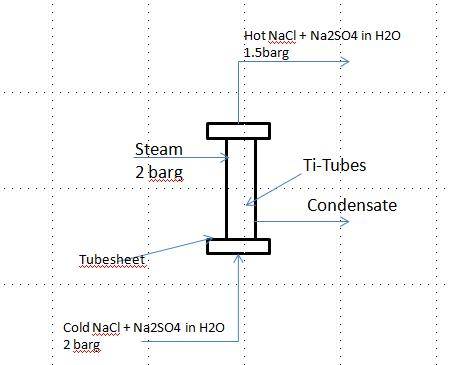

Ok, sorry. That's not what I meant. There's only two streams.
Perhaps this diagram clarifies things:
Okay, so the Teflon is dealing with steam pressure versus atmosphere. You are going to have to support it with some sort of plate, in which case you might want to look at packed glands through a plate. That kicks expenses up, but the creep rate for Teflon at that temperature is going to be an endless headache. Can you just run the process tubing as sleeves through a longer tube shell? Or, is that too much loss in heat transfer efficiency?Edit:
And, this does nothing but move the problem --- you've still got to come up with something for a tube sheet.
Second Edit:
Actually if the Ti cost is the constraint, steam jacket that length of Ti tubing, and forget the tube and shell configuration.
