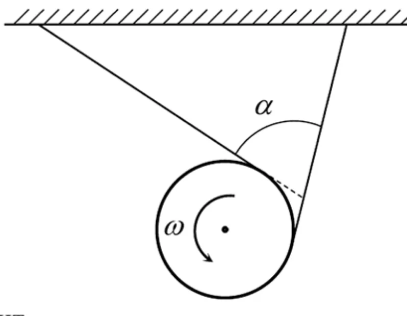

There is a disk of radius ##R##. The disk is wound with two inextensible strings, the ends of which are attached to the ceiling. At the moment in time shown in the picture, the strings are taut and the angle between them is equal to ##\alpha##. The disk has an angular velocity ##\omega##. Find the velocity of the disk's center.
Diagram of a disk of radius R hanging from two taut strings attached to a ceiling, with the angle between the strings marked alpha and the disk's angular velocity omega shown by a curved arrow.

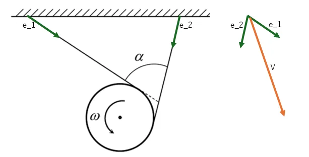

Diagram of a wheel of angular velocity omega rolling under a belt suspended from a ceiling, with unit vectors e_1 and e_2 along the two belt segments, angle alpha marked at the top, and a vector diagram on the right showing e_2, e_1 and a resultant V.
$$(\mathbf{v}-R\omega\mathbf{e_1})\cdot\mathbf{e}_1=0$$
$$(\mathbf{v}-R\omega\mathbf{e_2})\cdot\mathbf{e}_2=0$$
So
$$\mathbf{v}\cdot\mathbf{e_1}=\mathbf{v}\cdot\mathbf{e_2}=R\omega$$
and
$$\mathbf{e_1}\cdot\mathbf{e_2}=\cos\alpha$$
Thus
$$\mathbf{v}=\frac{R\omega}{\cos\frac{\alpha}{2}} \frac{\mathbf{e_1}+\mathbf{e_2}}{2\cos\frac{\alpha}{2}}$$
where obviously
$$|\frac{\mathbf{e_1}+\mathbf{e_2}}{2\cos\frac{\alpha}{2}}|=1$$
