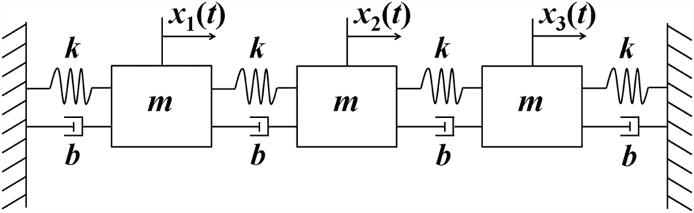

For example, knowing that the system has, say, a multitude of masses, each connected by a spring, as below...
(IGNORE DAMPING and applied forces FOR NOW)
Diagram of three equal masses m in a row between two walls, each connected to its neighbours and the walls by springs k and dampers b, with displacements x1(t), x2(t) and x3(t) marked to the right of each mass.
... how do you KNOW that modal analysis will provide the foundation for all solutions?
All I see is that if I use Hamilton's principle, I will get three coupled differential equations. I try to solve it,
and find that if I use the standard approach, I obtain the NULL solution. So, then I am MOTIVATED to
seek a matrix that is rank deficient, (determinant = 0) to get the characteristic equations.
How do I KNOW this will work?
It is such a strange thing to want to do: "Create a matrix based statement of the three coupled differential equations and assume each mass moves with the same frequency (justify?) and that we see a null solution (justify) to get the characteristic equations and then normalized eigenvectors (Justify?) It works, I get it, but how do you "feel/know/intuit" it, in advance?

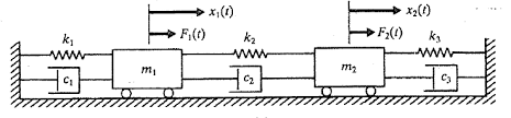

  • Diagram of a two-mass system: two masses m1 and m2 on a horizontal base, each attached by springs k1, k2, k3 and dampers c1, c2, c3 to the walls and to each other, with displacements x1(t) and x2(t) and forces F1(t) and F2(t) shown as arrows.
