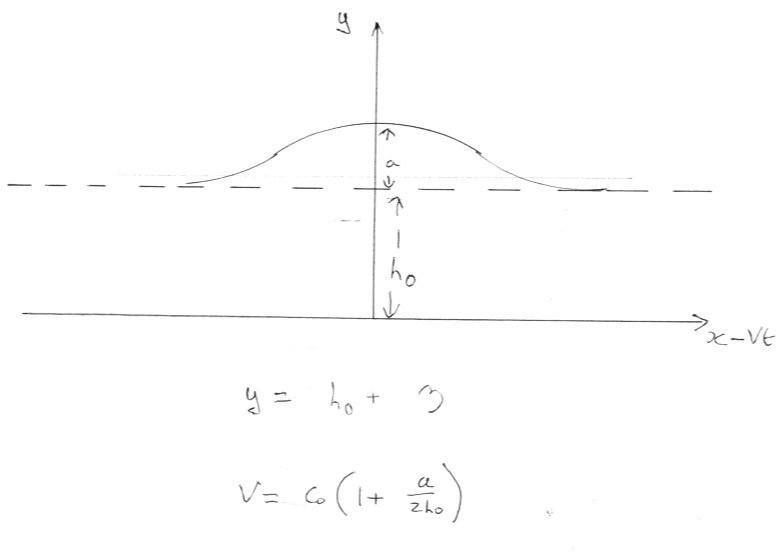

Here is the wave in terms of some real world quantities.
a is the amplitude eta is the (wave) function which describes the action (shape), c0 is the velocity.
h0 is the undisturbed depth.
Note the usual wave (x-Vt) on the horiz axis ie a function of x and time.
The soliton is traveling left to right and we ignore the left hand (negative) half.
The KDV for water solitons is
[tex]\frac{{\partial \eta }}{{\partial t}} + {c_0}\frac{{\partial \eta }}{{\partial x}} + \frac{{3{c_0}}}{{2{h_0}}}\eta \frac{{\partial \eta }}{{\partial x}} + \frac{{1{c_0}h_0^2}}{6}\frac{{{\partial ^3}\eta }}{{\partial {x^3}}} = 0[/tex]

A solution is
[tex]\eta = a\sec {h^2}\left\{ {\sqrt {\frac{{3a}}{{4h_0^3}}} } \right.\left. {\frac{{\left( {x - Vt} \right)}}{1}} \right\}[/tex]
Note I said 'A solution is'. As you note there are many, but we want one that decays away to infinity on either side as I said in my previous derivation.
Would you like the derivation in this format, rather than as previous?
Does this help?

Surely you have the real world variables in the last version of the equation I posted plus the sketch?
If you want to consider the conditions under which a soliton will form then you need to go back to the KDV and consider varying each term. The third term is the nonlinear one which is added to include for dispersion.
