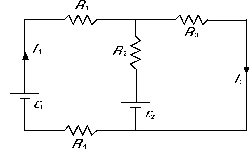

I need help trying to find the current I1 which flows through R1 and the current I3 that flows through R3.
Given:
E1=8V
E2=4V
R1= 110
R2=40
R3=50
R4=50
I figured out that the first equation is: I1=I2+I3
The 2nd equation: 8V-160I1-40I2-50I3=0
3rd equation: 4V+40I2-50I3=0
I'm not sure what to do from here.
thank you:)
Your second equation is wrong. fix that, and then you will have a set of 3 equation for three unknowns (I_1,I_2,I_3). Solve this system of equations and you are done.
