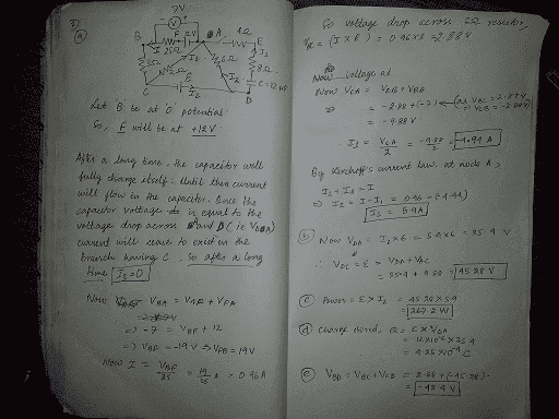

How do you do part e? Also can someone explain why the current I3 isn't 0 if the switch has been closed for a long time? Doesn't it behave like a short circuit if the switch is closed because the capacitor becomes fully charged and the current becomes zero ish?

This is simple circuit analysis. You have to show an attempt yourself.
If the switch has been closed for a long time that current is zero.
No, it becomes an OPEN circuit and the current is zeor-ish.

Oh this was from a test, I could have shown it but I got 5.5/10 on it so it wasn't very useful.

Do you guys think these answers are correct? I posted the problem to chegg but I have like 3 different answers. I think this one might might be legit, but I don't know if it's really discharging or not. I think it's charging up because it's an open circuit and current is trying to pass through it but it's fully charged. I don't understand what he did for part D so I think that's wrong, but everything else is legit.
(or on imgur)
http://i.imgur.com/KxAoeQ4.jpg?2
