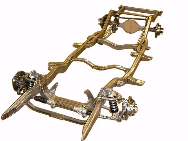

A ladder chassis is a platform on which you put an entire body, like this:

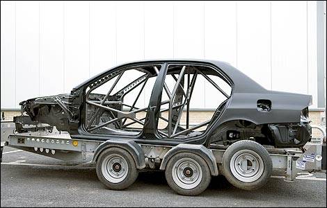

By doing so, the original monocoque structure was completely altered. It is much easier to calculate, test and built a box chassis that will be put within the new shorten body, than to try to built a completely new monocoque chassis because monocoque chassis are usually done by using materials of different strength placed in strategic places (represented by the different shades of blue in the previous picture). This is often done in race cars that are re-inforced:
