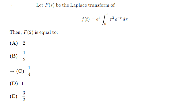

I'm having trouble with this question. Can anyone please guide me.
My Attempt :
= 1/(s-1) * L{t^2*e^-t}
= 1/(s-1) * (2/(s+1)^3)
= 2/((s-1)(s+1)^3))
but that's not the answer , its 2/((s-1) s^3) somehow.
The question is attached below.
  • Multiple-choice problem: F(s) is the Laplace transform of f(t) = e^t times the integral from 0 to t of τ² e^(-τ) dτ. Options: A) 2, B) 1/2, C) 1/4, D) 1, E) 3/2.

You are correct: it really is 2/[(s-1)(s+1)^3].
But on the test it says its 2/(s^3 *(s-1)), and wolfram alpha confirms it too... The question asked to find F(2).. according to my solution i will get 2/(3^3) which is 2/27 but the answer is 1/4

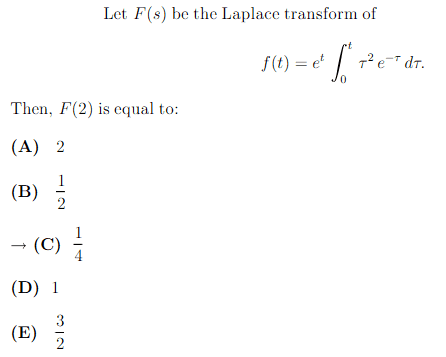

This is the exact question... no option of 2/27 :(
  • Multiple-choice problem: Let F(s) be the Laplace transform of f(t) = e^t times the integral from 0 to t of τ² e^(-τ) dτ. Then F(2) is equal to options (A) 2, (B) 1/2, (C) 1/4, (D) 1, (E) 3/2.

I don't get what you did there.
Pull the exponential in front back inside the integral and then identify the integral as a convolution of two functions. What two functions are they?
I'm confused here... are u saying i should put e^t inside integral and do L{e*t^2}?
No, how did you get that? You do realize the integral isn't a Laplace transform, right? When you pull the exponential back in, you get
$$f(t) = \int_0^t \tau^2 e^{t-\tau}\,d\tau.$$ You should recognize the form of that integral.
oh wow , i get it now. Thanks you so much for helping.
