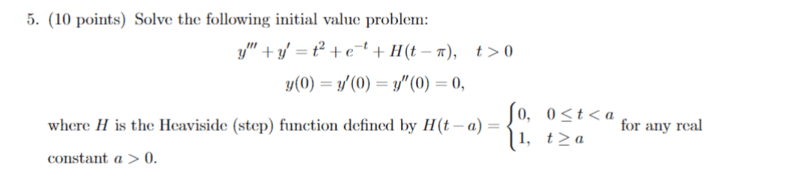

For this problem,
Homework problem 5 (10 points): solve y''' + y' = t^2 + e^(-t) + H(t - pi), t > 0, with y(0) = y'(0) = y''(0) = 0, where H(t - a) is the Heaviside step function, 0 for t < a and 1 for t >= a, for any constant a > 0.

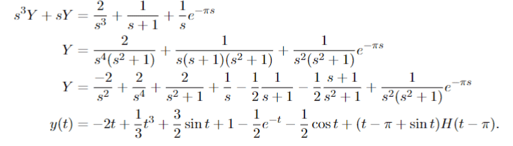

The solution is,
Worked partial fraction and inverse Laplace transform solution: s^3Y + sY = 2/s^3 + 1/(s+1) + (1/s)e^(-πs), followed by partial fraction expansions of Y and the final y(t) = -2t + (1/3)t^3 + (3/2)sin t + 1 - (1/2)e^(-t) - (1/2)cos t + (t - π + sin t)H(t - π).
However, I'm confused by the partial fraction decomposition of ##\frac{2}{s^4(s^2 + 1)}##
I never done that sort of thing before. However, I think it would be done like this (Please correct me if I am wrong, the algebra is crazy here).
##\frac{2}{s^4(s^2 + 1)} = \frac{A}{s} + \frac{Bs + C}{s^2} + \frac{Ds^2 + Es + F}{s^3} + \frac{Gs^3 + Hs^2 + Js + K}{s^4} + \frac{Ls + M}{s^2 + 1}##
It seems rather tedious because of the ##\frac{1}{s^4}##, but is that correct (There may be a simpler method but I can't see it).
Thanks!

No, that isn't right. For repeated linear factors and their powers (i.e., ##s, s^2, s^3, s^4##), the decomposition would look like this:
##\frac{2}{s^4(s^2 + 1)} = \frac{A}{s} + \frac{B}{s^2} + \frac{C}{s^3} + \frac{D}{s^4} + \frac{Es + F}{s^2 + 1}##.
The ##As + B## numerators would go with irreducible quadratic factors, such as the ##s^2 + 1## factor in the denominator.
