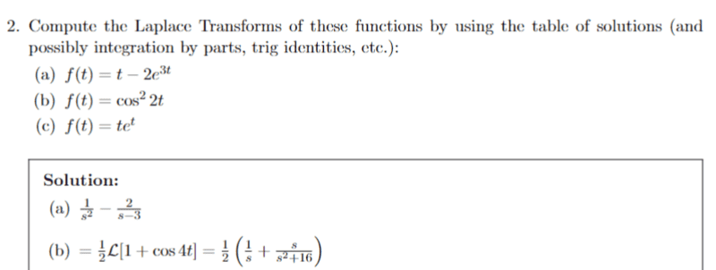

##L[(\cos^2 (2t)] = L[\cos 2t] * L[\cos 2t]##
For part (b),
Textbook problem 2 asking for Laplace transforms of three functions, with a worked solution for parts (a) and (b): (a) 1/s^2 - 2/(s-3); (b) (1/2)L[1 + cos 4t] = (1/2)(1/s + s/(s^2+16)).
I have tried finding the Laplace transform of via the convolution property of Laplace transform.
My working is,
##L[\cos^2 (2t)] = L[\cos 2t] * L[\cos 2t]##
##L[\cos^2 (2t)] = \frac{s}{s^2 + 4} * \frac{s}{s^2 + 4}##
##\int_0^t \frac{s^2}{(s^2 + 4)^2} dt = \frac{ts^2}{(s^2 + 4)^2}##
However, I don't see how that is equivalent/equal to the expression they got for (b). Does some please know how or if I've made a mistake?
Thanks!
Your working is wrong. You are trying to make a convolution, but that is not how it is done. Please look up the actual expression for a convolution.
Nb: the easiest way to solve this is using trig identities as done in the solution.
