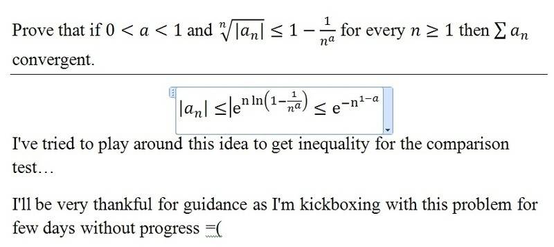

I have hard time with latex so I attached all relevant info in that picture file.:redface:
Thanks you in advance!
Do not make it complicated
take the limit(as n goes to infinity) of both sides of the inequality in the question (the inequality which has the nth rooth of the absolute value of an)
the left side will be simply the limit which is in the root test and the right side will be 1
so the limit of the nth root of the absolute value of an is less than 1
so the series converges by the nth root test.

I'm not sure if I get you right.
The root test tell us something only if the limit is not 1, but in our case the limit is 1.
No.
Take the limit of both sides as I said, the limit of the right side will be 1
so the limit of the right side (which the nth root of the absolute value of an) is LESS THAN 1 ---> The series converges by the root test.

Where in the inequality you see "LESS THAN"? (It's less OR EQUAL to)
OBVIOUSLY, the root test CAN'T be used here.
yeah, its less than or equal

your website said: if L < 1 then the series absolutely convergent (hence convergent).
Its agree with my conclusion :)
If you mean less than or EQUAL , then you could consider the inequality starts from n=2, and this will be remove the "EQUAL" sign from the inequality
Finally, you know that the finite sum does not affect the convergence of the series, so it will include the 1.

The limit is LESS OR EQUAL to 1, means the limit CAN be 1, which means you CAN'T use the root test!

I'm not sure if this is right but what I did was:
let bn = 1 - 1/n^a, for 0 < a < 1, and an = bn ^ n; by virtue of the root test, this converges since the limit is between but not equal to 0 and 1.
I'm not sure but I think it is not. Again root test can't be used here.(despite the resemblance)
Good for you for resisting all of the bad root test advice. You could try to apply an integral test to exp(-n^(1-a)). It gives you an incomplete gamma function, if you know how to deal with that. I mostly know this because I typed it into Maxima. It diverges as a->1, of course, but seems to be finite on a in (0,1).

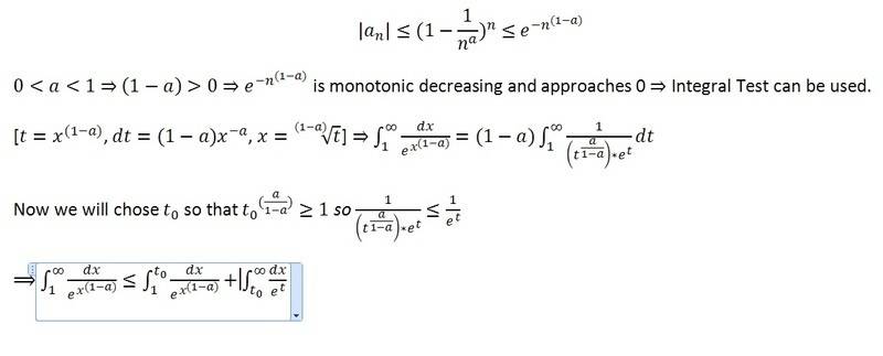

Here is my raw attempt, I'm on right way? (My integration is a little nasty...)
If all I did is ok it should be trivial from where I stopped.

Double check that. If you do it right the new integral should be t^(a/(1-a))*exp(-t). That means the power of t is positive, so t^(a/(1-a)) never becomes less than 1. You want to show this converges by showing exp(-t) goes to zero fast enough. exp(t) grows faster than any polynomial in t as t->infinity, right?

Oh, I blundered with my integration.
But now how can I show that Integral_(t^(a/1-a)/e^t)dt from 1 to infinity is convergent?
But now how can I show that t^(a/1-a)/e^t goes to 0 fast enough?
Call K=(a/(1-a)). For any N you can find t large enough so that exp(t)>t^N. Pick N=K+2 for example.

But 1<x for every x>1 and still integral_(1/x)dx from 2 to infinity is not convergent.
I have trouble showing integral_(t^K/e^t)dt is convergent.

I'm not suggesting you show t^K/e^t is less than 1. I'm suggesting you show it's less than 1/t^2 for large t.
Limit comparison test! Don't know how I missed it...
