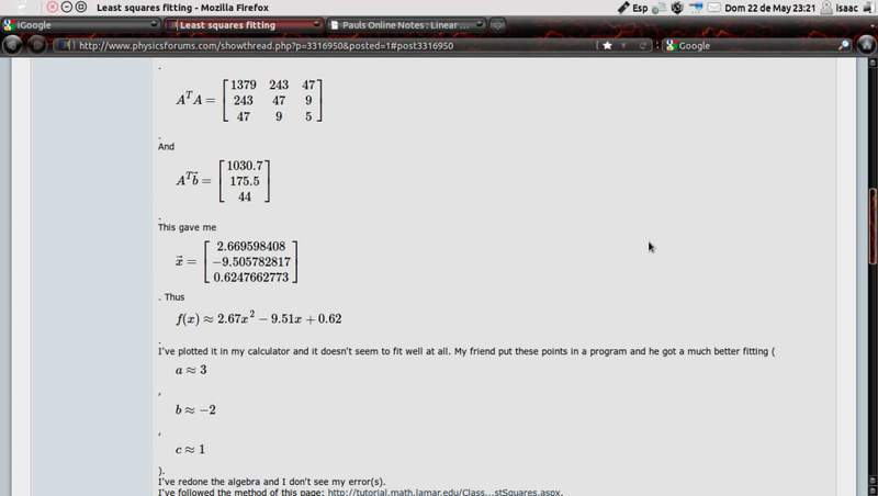

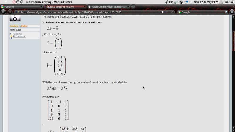

I must find the best fitting function of the form ax²+bx+c using least squares.
The points are (-1,6.1), (0,2.8), (1,2.2), (3,6) and (6,26.9).
2. Homework Equations + attempt at a solution
[tex]A\vec x= \vec b[/tex], I'm looking for [tex]\vec x =\begin {pmatrix} a \\ b \\ c \end {pmatrix}[/tex]. I know that [tex]\vec b = \begin {pmatrix} 6.1 \\ 2.8 \\ 2.2 \\ 6 \\ 26.9 \end {pmatrix}[/tex].
With the use of some theory, the system I want to solve is equivalent to [tex]A^{T}A \vec x = A^{T} \vec b[/tex].
My matrix A is [tex]\begin {bmatrix} 1 & -1 & 1 \\ 0 & 0 & 1 \\ 1 & 1 & 1 \\ 9 & 3 & 1 \\ 36 & 6 & 1 \end {bmatrix}[/tex].
[tex]A^{T}A=\begin {bmatrix} 1379 & 243 & 47 \\ 243 & 47 & 9 \\ 47 & 9 & 5 \end {bmatrix}[/tex].
And [tex]A^{T}\vec b = \begin {bmatrix} 1030.7 \\ 175.5 \\ 44 \end {bmatrix}[/tex].
This gave me [tex]\vec x = \begin {bmatrix} 2.669598408 \\ -9.505782817 \\ 0.6247662773 \end {bmatrix}[/tex]. Thus [tex]f(x) \approx 2.67 x^2-9.51 x +0.62[/tex].
I've plotted it in my calculator and it doesn't seem to fit well at all. My friend put these points in a program and he got a much better fitting ([tex]a \approx 3[/tex], [tex]b \approx -2[/tex], [tex]c \approx 1[/tex]).
I've redone the algebra and I don't see my error(s).
I've followed the method of this page: http://tutorial.math.lamar.edu/Classes/LinAlg/LeastSquares.aspx.
I got right all problems involving a linear fit, but failed all other fits (exponentials, quadratic, etc.). What am I doing wrong?!
Another question that really matters to me is... why don't we solve Ax=b directly since we know both A and b, we would get 3 equations with 3 unknowns... why bother with the transpose of A?
Thank you very much for any help.

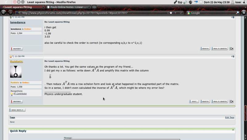

so how do you get your final x?
shouldn't it be
(A^T.A)^(-1).(A^T.b)
if i do that i get different values to you...
i then get
0.99
-1.99
3.03
also be careful to check the order is correct (ie corresponding a,b,c to x^2,x,1)
Oh thanks a lot. You get the same values as the program of my friend...
I did get my x as follows: write down [itex]A^TA[/itex] and amplify this matrix with the column [tex]\vec b[/tex]. Then reduce [itex]A^TA[/itex] into a row echelon form and look at what happened in the augmented part of the matrix.
So in a sense, I didn't even calculated the inverse of [itex]A^TA[/itex], which might be where my error lies?

should lead to the same result, maybe you're missing the A^T on the right side?
[itex]A.x = b[/itex]
[itex]A^T.A.x = A^T.b[/itex]
then
[itex]((A^T.A)^-1)(A^T.A).x = ((A^T.A)^-1)(A^T.b)[/itex]
[itex]x = ((A^T.A)^-1)(A^T.b)[/itex]
