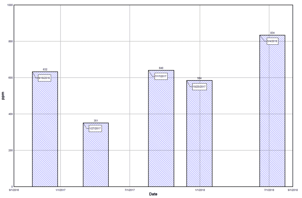

I found that they use the Karl Fischer method (ASTM-D6304). The values I have indicate the following: (DDMMYY)
632 ppm on 16/09/16
351 ppm on 27/01/17
640 ppm on 20/07/17
584 ppm on 25/10/17
834 ppm on 4/05/18

Is the oil basestock mineral (petroleum) or one of the synthetics? I'm guessing mineral oil if you are seeing emulsification at these water concentrations, although (in air compressors, at least) typically a synthetic is preferred. Can you post what specific oil is used, for instance, Mobil Rarus 400 series, etc.?
How often is the oil changed? Was it changed at least once since the first (Sept 16, 2016) water ppm reading provided?
Bar chart of water content in ppm by date, from 9/1/2016 to 9/1/2018. Bars: 632 (9/16/2016), 351 (1/27/2017), 640 (7/17/2017), 584 (10/25/2017), 834 (5/4/2018). Y-axis labeled ppm, 0 to 1000.
Time was, water content under 1000 ppm was considered OK (at least, in gearbox applications - what the oil is used for makes a big difference), but rule-of-thumb had dropped to 500 ppm or less as the deleterious effects of water contamination have become better understood. Less water >> greater equipment reliability.
If this were an unpressurized gearbox, a cheap and dirty way to reduce oil water content would be to drain the oil, thoroughly clean the gearbox, refill with new oil, and replace the breather cap with an indicating desiccant breather. In normal service, the color indicator should change gradually from the ambient, outside air side toward the gearbox. However, if the water source is on the gearbox side (typically, a leaky oil-to-water heat exchanger) then the color change will concentrate on that side, and indicate immediate service is required.
This isn't much use for you because, in this application, the oil sump is likely to be pressurized.
Consult with your equipment and oil vendors (processing combustible gases undoubtedly adds factors I'm unaware of), but I'm wondering whether an oil-drying 'kidney' loop would help. Something along the lines of this company's offerings.
