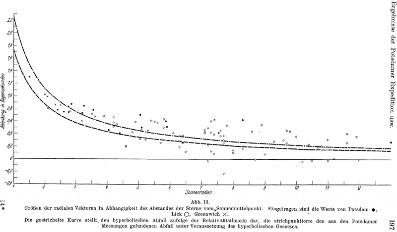

In the essay „Über die Ablenkung des Lichtes I am Schwere*feld der Sonne“ ( http://adsabs.harvard.edu/full/1931ZA...3..171F ) the authors - Freundlich,
Klüber and Brunn - presented 1931 graphically the results of three expeditions, which took place 1919, 1922 and 1929. They put together all the measurements,
so that it gave a comprehensive presentation of 99 test points (illustration).
Scatter plot of radial vector magnitudes in arcseconds against distance from the Sun's centre in solar radii, with two dash-dot and dashed hyperbolic curves falling from upper left to lower right.
For the authors the theory of relativity is clearly failed: „It looks quite evident that the theoretical (lower) hyperbole is not represented by the values.“ Therefore,
they still draw the upper hyperbola for the light deflection at the solar limb by 2.24". The high quality of the image allows precise to determine the coordinates of
the measuring points. This data can for example be entered into the Excel spreadsheet and processed. In particular we are interested for the sum of squared
deviations between theoretical curves and real measurement values​​. The smaller it is, the better the compensation. The next charts are sorted by rise
of the sum, i.e. first get the best results.

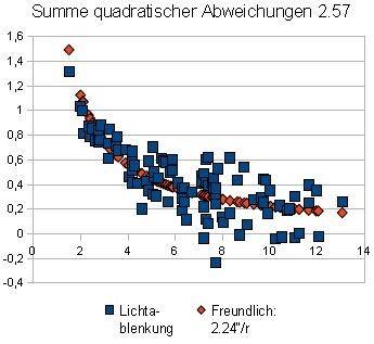

Scatter plot titled "Summe quadratischer Abweichungen 2.57" with blue squares for Lichtablenkung measurements and red diamonds for the Freundlich 2.24"/r curve, x-axis 0 to 14, y-axis -0.4 to 1.6.

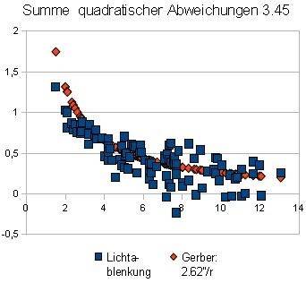

Scatter plot titled "Summe quadratischer Abweichungen 3.45" with blue squares labelled Lichtablenkung and red diamonds labelled Gerber: 2.62"/r; points cluster and decline from about 1.7 at x=1.5 toward 0 near x=13.

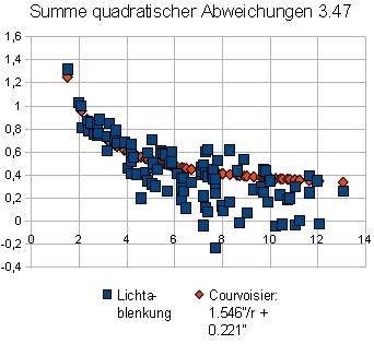

Scatter plot titled "Summe quadratischer Abweichungen 3.47" of light deflection measurements (y-axis 0 to 1.6) against solar distance r (x-axis 0 to 14), with blue squares for data points and a red diamond series labelled Courvoisier: 1.546"/r + 0.221".

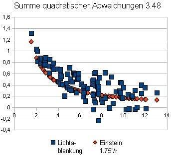

Scatter plot titled Summe quadratischer Abweichungen 3.48, with blue squares for Lichtablenkung data points and red diamonds for the Einstein 1.75"/r curve, x-axis 0 to 14, y-axis -0.4 to 1.6.

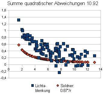

Scatter plot titled "Summe quadratischer Abweichungen 10.92" with blue squares labelled Lichtablenkung and red diamonds labelled Soldner 0.87"/r, plotted against x-axis 0 to 14 and y-axis -0.4 to 1.6.

1. Freundlich / 2.24"/r / empirically / 2.57

4. Gerber / 2.62"/r / theoretically / 3.45
5. Courvoier / 1.546"/r + 0.221" / empirically / 3.47
6. Einstein / 1.75"/r / theoretically / 3.48
7. Soldner / 0.87"/r / theoretically / 10.92

"die gestrichelte kurve stellt den hyperbolischen abfall zufolge der relativitatstheorie dar, die strichpunktierte den aus den potsdamer messungen gefundenen abfall unter voraussetzung des hyperbolischen gesetzes"="the dashed curve is the hyperbolic slope, according to the relativity is that the dot-dash potsdamer measurements found in the waste under the condition of the hyperbolic law" [obviously a poor translation, but I guess this means that the dot-dash one is just an arbitrary fit to a hyperbola?]

It looks like a good fit to me, particularly considering that there are no free parameters. How many free parameters do the other theories have? While having free parameters does allow a theory to fit data better the uncertainty in the parameters makes it worse at predicting data.
