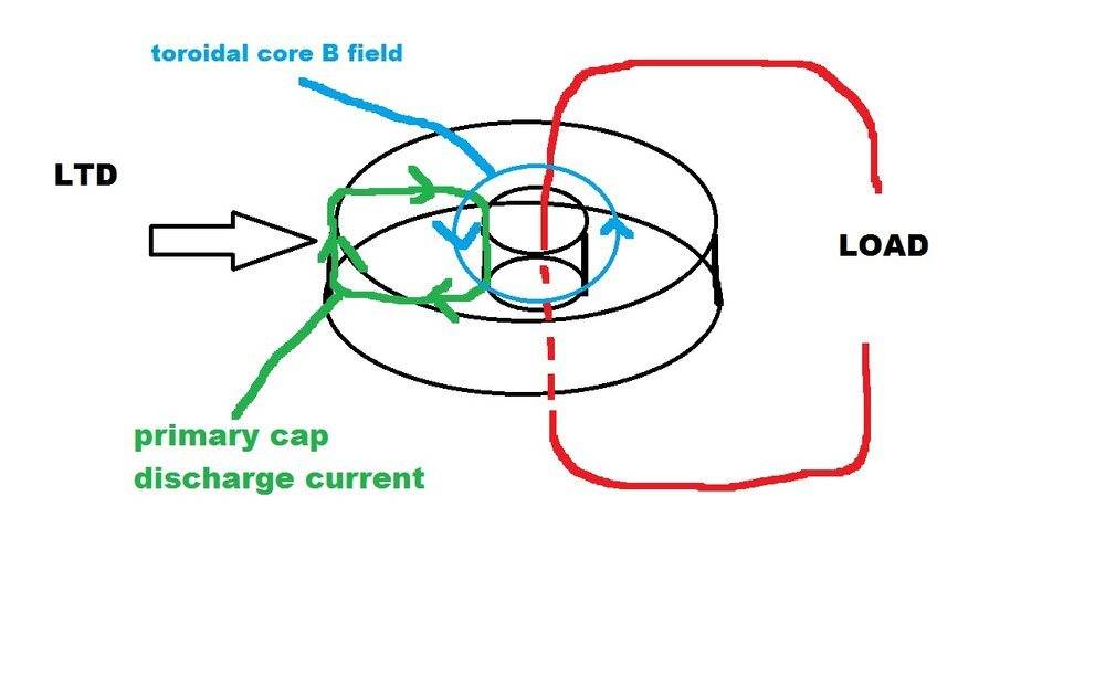

see this drawing I made in paint, I take that the basic LTD scheme resembles this one, so can I say it is essentially a specific type of a pulsed transformer because the basic transformer action here seems like in that of any other transformer just that the primary winding and it's driving elements are incorporated into the transformer for what I suppose are shorter wire distances and lower inductance for faster and stronger pulse forming.

It's not quite like an actual transformer. The caps are charged and have a direct electrical connection to the load - no magnetic shenanigans there. The reason the magnetic core exists is to increase inductance in the case of the ltd to ensure driving all current through the load. We drive a high current in a loop around the cores (~200A) to induce a magnetic field increasing induction . The russians actually used to just use a big ring of iron iirc, whereas we use thin magnetic tape wound a few thousand times between epoxy. You're correct about NEEDING lower inductance for LTD performance, and that's generally considered heavily in the design of the switch and capacitors and transmission lines.
Also, the "bricks" (2 capacitors and a switch) are all wired parallel. The LTD modules themselves are in series.
Pulse shaping is interesting though. For stronger pulses you obviously need all the bricks to fire at once into the load, but there have been some instances where doing weird pulse shaping has been important for experiments.
I looked at some schematics again , it seems to be the case , well I guess a better comparison would be that of an autotransformer , it seems the core is used so that there would be voltage gain somewhat like in an autotransformer?
Voltage for an LTD is a means to an end - the goal of an LTD is to achieve high current and a fast rise time. The energy stored in a capacitor is ~cv^2, so if we can get a high voltage on the caps, we can obviously deliver a lot of energy.
Also, the magnetic cores are usually just premagnetized before a shot occurs.
Again, the sole reason for the magnetic core is to stop current from going where we don't want it to, aka the case.
I should also clarify by "case", I mean the casing that envelopes the capacitors/switches/etc..

Ok @whyamianswering I think I get it, so each LTD toroid has a fixed voltage dictated by it;'s capacitors, and it's current is related to the number of "bricks" in parallel
within it, then stacking up many such toroid LTD's in series forming a barrel adds the total maximum voltage between the upper and lower end outputs , so the current is related to the current through an individual LTD toroid, but adding them in series increases the voltage so the total current through the load also then increases.

Anyway I now see the reason for the cores, yes indeed they have nothing to do with a transformer, the name transformer in the LTD seems misplaced.
