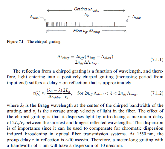

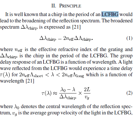

Here is my problem : I want to know where does group delay equation come form?
As I checked reference 21 it only indicates
I'm following how can I start and solve this problem
