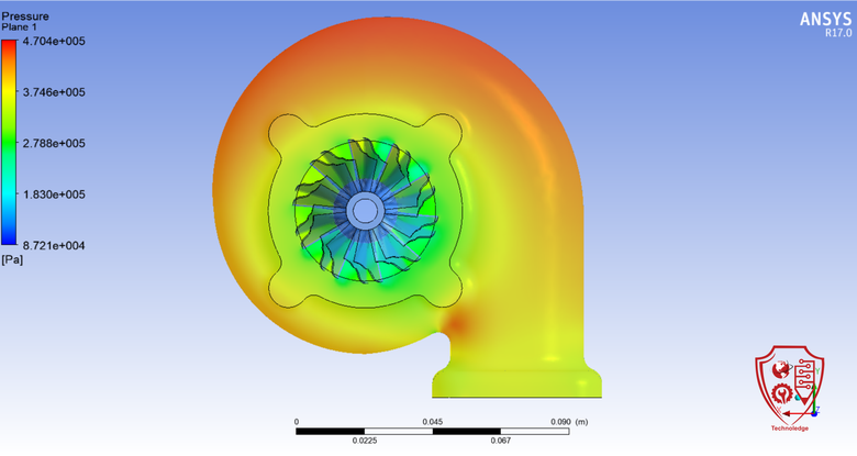

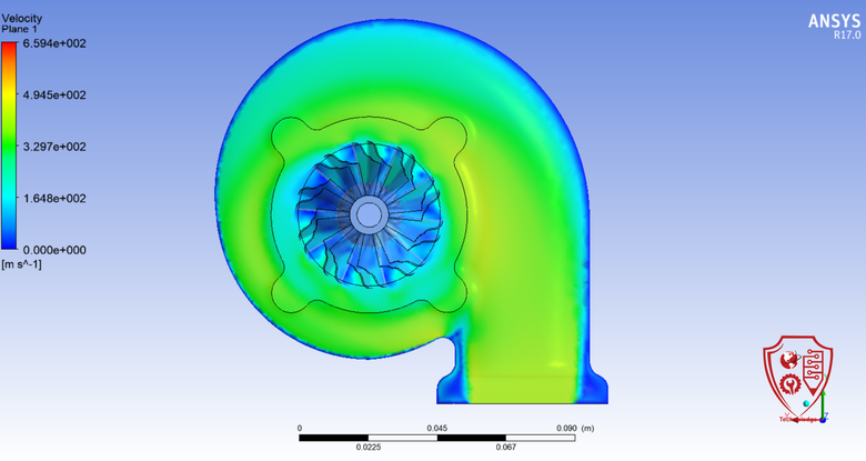

This is question for fluid mechanics.
Static pressure in the exhaust manifold(turbo car engine) is usually 1.2 to 2.5 times higher than the boost pressure(intake manifold pressure).Boost pressure is around 1bar guage pressure(2bar absolute).
Can the local static pressure somewhere inside a turbine housing ever be lower than atmospheric pressure, is this possible?
here some links where CFD is used:
https://www.linkedin.com/posts/comp...using-ansys-activity-6980110878163525632-AtDY
https://www.sciencedirect.com/science/article/pii/S2212540X24000221

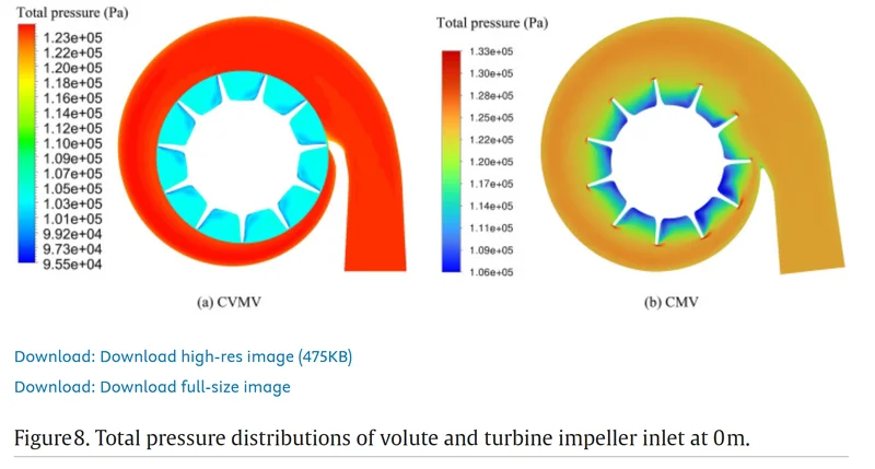

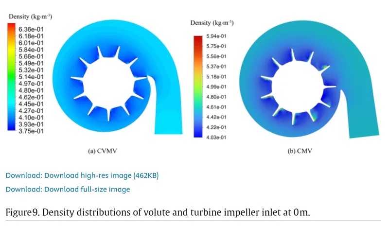

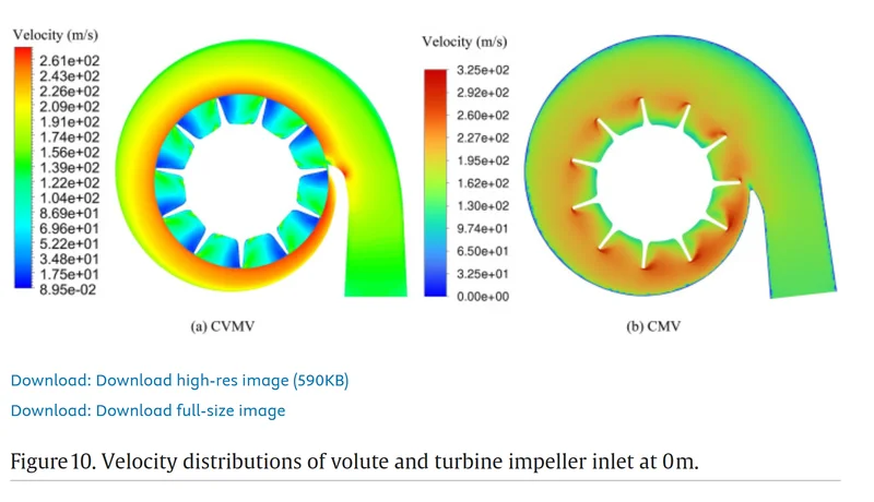

Can we from this below plots total pressure, velocity and density find minimum static pressure in turbine? Problem is gas velocity is very high 325m/s (1170km/h) so wil Bernoulli get correct static pressure? Is total pressure in plot, absolute or relative?
link source: https://www.sciencedirect.com/science/article/pii/S2212540X24000221

Is total pressure from my post #4 absolute or guage pressure?
In a compressible flow, "gauge" total pressure doesn't really make any sense.
With incompressible flow, total pressure is an addition:
$$p_{total_{abs}} = p_{static_{abs}}+½\rho v^2$$
So:
$$(p_{total_{gauge}} + p_{atm}) = (p_{static_{gauge}} + p_{atm}) + ½\rho v^2$$
Therefore the equation works as equally well with gauge pressure:
$$p_{total_{gauge}} = p_{static_{gauge}}+½\rho v^2$$
With compressible flow, total pressure is a ratio:
$$\frac{p_{total_{abs}}}{p_{static_{abs}}} = \left(1+\frac{\gamma - 1}{2}M^2\right)^{\frac{\gamma}{\gamma - 1}}$$
$$\frac{(p_{total_{gauge}} + p_{atm})}{(p_{static_{gauge}} + p_{atm})} = \left(1+\frac{\gamma - 1}{2}M^2\right)^{\frac{\gamma}{\gamma - 1}}$$
So, if one would use gauge pressures with compressible flow, it would have to come with a value for ##p_{atm}## to validate them and it would be very confusing.
Short answer: total pressures in the context of compressible flow are always represented with absolute values.

If I use data from plot, density=0.4kg/m3, minimum total pressure(blue)= 1.06e+05Pa, velocity=325m/s, using compressible equations I get static pressure= 71000 Pa, so static pressure in that section of turbine is lower than atmospheric pressure.
Did you get the same?

$$ p = 106000\ Pa \times \left(1 - \frac{(325\ m/s)^2}{2\times 3.5}\frac{0.4\ kg/m³}{106000\ Pa}\right)^{3.5} = 86336\ Pa$$

Your numbers seem to come from behind the impeller tip, where it would be normal to have a low-pressure area as the impeller turns. But even at this point, the total pressure seem to be 133 000 Pa rather than 106 000 Pa. (Which sets the static pressure a little above the atmospheric pressure.)
If you look at the numbers closer to the impeller base (where it is closer to where you are afraid oil could get in), you have velocities closer to 90 m/s, with similar density and pressure you indicated. The calculations set the static pressure closer to the atmospheric pressure.
That being said, I don't think those graphs show accurate values for positions behind the impeller wheel, where the bearing seals are.
