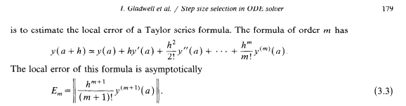

Actually I also have the same result as yours. I seem to be unable to replicate the constant step case. I, however, found this paper: Automatic selection of the initial step size for an ODE solver and taking a glance at Equation (3.3);
Printed journal page header reading I. Gladwell et al. / Step size selection in ODE solver, page 179, with text on estimating local error of a Taylor series formula and equation (3.3) for the asymptotic local error E_m.
It's weird since it actually replicates the order of the formula of the first paper if I assign the constant step case! The coefficient is not the same however, the original one would result to something like 1/3 and this one would result to 1/6. Strange. At least your attempt also ends up with the same order of h, but all these varying constants confuse me even more o:)
Anyway, I understand that the Taylor approach is quite straightforward. I am more curious however how the varying stepsize formulation is obtained. Could this be actually related to Lagrange polynomials? As far as I understand the only means for one to extract variable-step BDF formulations is via a polynomial interpolation approach.
