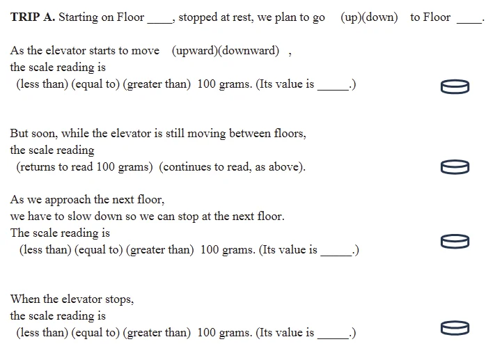

I had my students ride an elevator and watch a digital scale with a 100g mass sitting on top of it.
As they rode the elevator, i told them to make a video of the scale reading while narrating what the elevator was doing.
Here's part of a sheet that they fill out and circle while riding.
When they return to their desks, they draw the free-body diagram at each stage.
Worksheet titled TRIP A with fill-in-the-blank and circle-choice questions about a 100 gram scale reading in an elevator as it starts, moves, slows and stops between floors.
