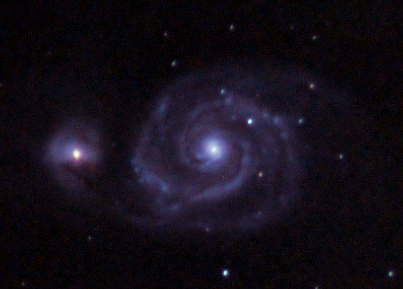

And lo, after 8 days of rain, the night sky did appeareth:
1 hour total integration time@ 800/5.6, ISO 2000.

Nice shot. What was your optical train?
Just my telephoto lens and Sony a850... am I misinterpreting? Each exposure was 20s long...(?)
That's an 800mm telephoto lens? Impressive lens! What was it mounted on?
Well Done Andy !
Don't think I can see that one from here in the southern hemisphere ... aahh Stellarium tells me it gets to only a few deg above the horizon :frown: I would be shooting through murky thick atmosphere
I know its a perennial fav for the nthrn hemisphere guys
Im assuming that this was a 100% crop of the original image ( ie. you didn't resize the image out of the camera before cropping)
as M51 wouldn't fill the frame like that with 800mm on a full frame sensor ( nor on a aps-c sensor either for that matter)
and would explain the fuzziness and noise
This thread may be of interest to you astrophotographers ...
http://photography-on-the.net/forum/showthread.php?p=17500235Dave
I rewarded myself three years ago with a Losmandy GM8- and have been extremely happy with it. I went from zero experience to 20s exposures in 15 minutes- alignment is trivial.
davenn said:
<snip>Im assuming that this was a 100% crop of the original image <snip>
Yep- that's a crop. The full frame shows nearby galaxies NGC 5198, IC 4263, and IC 4282. The image I posted here was made from jpgs, which accounts for most for the quality problems- The RAW version looks much better, not sure why I haven't posted that yet...

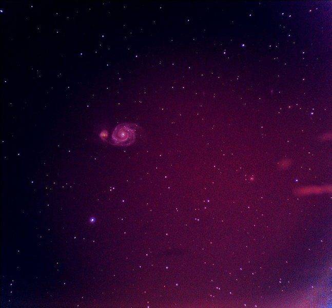

Had another good viewing night last weekend, was able to sharpen things up a bit. Here's essentially the full-frame (central 2/3, anyway):
It still needs some work, but the nearby low-surface brightness galaxies IC 4263, NGC 5169, and IC 4278 are clearly visible. Here's the 1:1 closeup:
Not bad... now it's time to switch over to the Virgo supercluster (weather permitting...)
Edit- slowly getting the hang of this whole 'post processing' thing...
