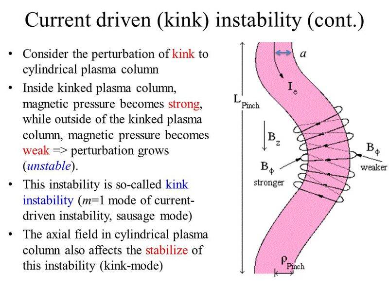

In the context of my question, the instabilities of primary concern would be kink instability and the Rayleigh-Taylor instability, which I will define with these very helpful photos below.
(1st photo is kink instability, 2nd photo is Rayleigh-Taylor instability)
