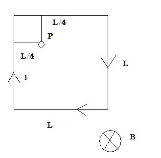

Magnetic field of square circut

Calculate the B-field at point P in the figure. Is the field strength at P greater or less then at the centre of the square?
don't laugh at my bad drawing :(
my problem is I'm not sure what method I'm supposed to use. I think its a method that involves integration...
Biot and Savart
[tex]d\vec{B}=k_{m}I\frac{d\vec{s}x\hat{R}}{R^{2}}[/tex]Ampere's Law
[tex]\Gamma_{B}=\int\vec{B}\cdotd\vec{s}[/tex]
edit* it should be dot ds and closed integral
and just a general idea would be appreciated. thanks.
ps i hope the text works

You should be able to integrate using Biot Savart. Concentrate on finding the field for a straight line, and then use superposition to add up the field from all linear pieces of the circuit.
thanks. i will try that
