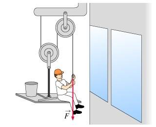

i have a similar question:
A man with mass M is sitting on a platform suspended by a system of cables and pulleys as shown . He is pulling on the cable with a force of magnitude F. The cables and pulleys are ideal (massless and frictionless), and the platform has negligible mass.
Find the magnitude of the minimum force that allows the man to move upward.
Base on what you have talked about, isn't it the F would be Mg/2 ??
or there are three ropes, so divide by 3?
It depends on how many times the rope pulls up on the "man+platform". Realize that the pulley attached to the platform is part of the "man+platform". Note that the pulley arrangement in this problem is different than in the previous problem in this thread--here we have two pulleys connected. That makes a big difference.
Right!
