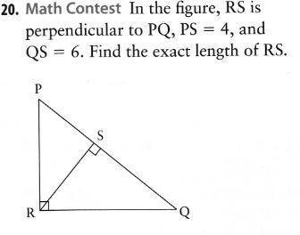

Hey guys I am preparing for a math contest and this is a review set that we have recieved, however i have no idea how to answer these questions,
Can someone please help with some reasonable solutions with some explanation.
Thanks

20. Which triangles are similar in that picture?
