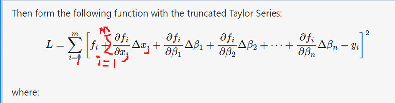

Then form the following function with the truncated Taylor Series:
$$\begin{equation*}
L = \sum_{i=0}^m \left[ f_i
+ \frac{\partial f_i}{\partial x_i} \Delta x_i
+ \frac{\partial f_i}{\partial \beta_1} \Delta \beta_1
+ \frac{\partial f_i}{\partial \beta_2} \Delta \beta_2 + \dots
+ \frac{\partial f_i}{\partial \beta_n} \Delta \beta_n - y_i
\right]^2 \end{equation*}$$

The ##\partial x_i## in the second term of the sum matches the ##\Delta x_i## but doesn't seem right because it implies ##f=f(\vec{x};\vec{\beta})## which isn't true, but using ##\partial x## instead doesn't seem right either because it doesn't match ##\Delta x_i##. How to handle?
I guess that L would be :
Does it make sense ?
Thanks for you comment (and catching the error on the sum index). If I wanted to make the expression for L more compact, it would be:
$$\begin{equation*}
L = \sum_{i=1}^m \left[ f_i - y_i + \frac{\partial f_i}{\partial x_i} \Delta x_i
+ \sum_{k=1}^n \frac{\partial f_i}{\partial \beta_k} \Delta \beta_k \right]^2
\end{equation*}$$
but the dilemma remains with ##\partial x_i##. It's a strange situation; ##f## has only one ##x## as an independent variable but the sum involves ##m## values of ##x##. I'm tempted to use:
$$\frac{\partial f_i}{\partial x} \Delta x_i$$ but it just doesn't look right.
