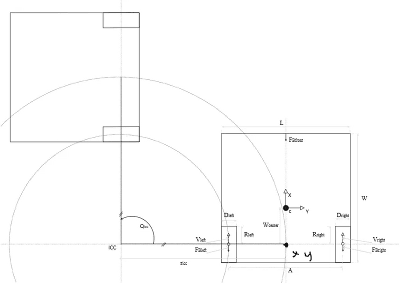

Greetings readers! I am writing this post because I have a problem and I cannot proceed further. My task is to develop a mathematical model designed to plan the movement of a sumo robot, or x=AX + BX, where all are matrices and AX are the matrices of new coordinates, while BX are the control matrices.
In this image, I have schematically drawn the schematic diagram of the entire robot and part of the ICC theory.

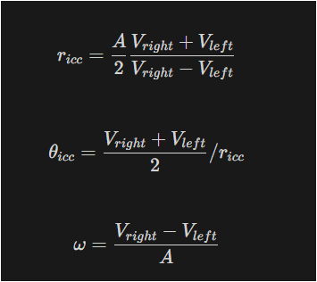

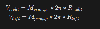

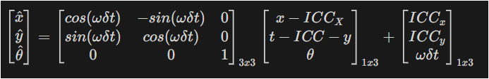

So the equations I have written would be like this. (Unfortunately I can't find how to insert latex into this page)
So the final mathematical model should be like this. However, after testing, it doesn't get the correct next values, and I don't know why. Maybe someone can help?
Thanks for any help!
