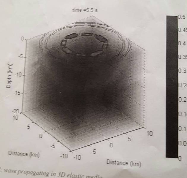

I'm trying to generate contours that plot with the animation using contour(X,Y) but it's not quite working. I only need it to be in the x-y plane at 0km depth (see picture for greater clarification)

Ah, all it was was a simple case of adding
Matlab:
contour(X(:,:,21),Y(:,:,21),wf(:,:,21));
