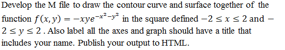

Printed text instructions: Develop the M file to draw the contour curve and surface together of the function f(x,y) = -xye^(-x^2-y^2) in the square defined -2 ≤ x ≤ 2 and 2 ≤ y ≤ 2. Also label all the axes and graph should have a title that includes your name. Publish your output to HTML.

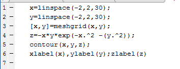

MATLAB script showing linspace grids, meshgrid, z = -x*y*exp(-x.^2 - y.^2), contour(x,y,z), and xlabel, ylabel, zlabel calls.
look at line4, did I enter it correctly?

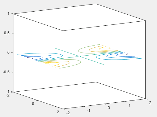

I must have did something wrong because there is no contour at all, all i see are parallel lines.
You are probably intending to use element-by-element multiplication, but you have used matrix multiplication. You need to use the .* operator instead.
  • MATLAB 3D plot in a bounding box with axes from -2 to 2 and vertical range -1 to 1, showing multicolored contour curves in colors like blue, yellow and green on two level planes.

  • Screenshot of a six-line MATLAB script: x and y defined with linspace(-2,2,30), meshgrid(x,y), z = -x.*y.*exp(-(x.^2+y.^2)), clf, and contour(x,y,z).
