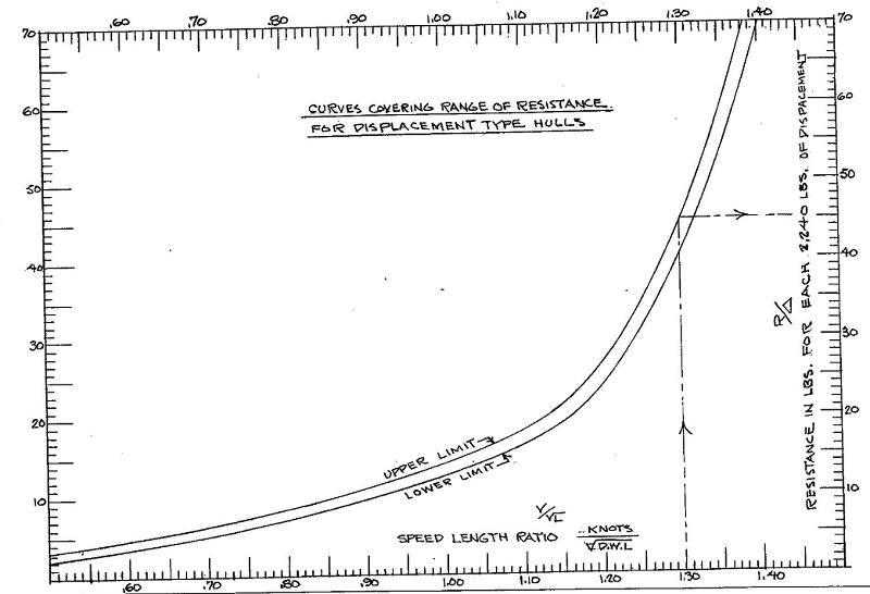

The resistance vs speed of a displacement hull, as stated above, is complex. Skene's Elements of Yacht Design, 8th Edition, has the following graph for hull resistance vs speed. It's for sailboats, and will probably change for the long, slim hull of a scull.
